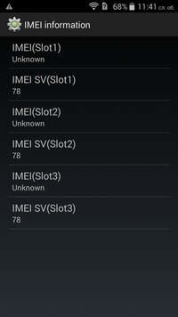

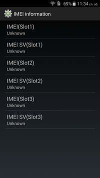

Hello,
Please, excuse me for the English but my German is not good enough.
I "Format All+Download" via Flash Tool my Acer Liquid E700 (E39) and brick it.
With help of the android-hilfe.de forums I manage to recover phone and almost all is fine EXCEPT the IMEIs.
It shows "Unknown" on all 3.
I try "MTK writer IMEI" tool but it have only 2 IMEIs.
Even with 2 IMEI genereted "MP0B_001" file it shows "Unknown" also on the subversions.
I have my IMEIs written on the phone box.
Can you please help me to generate correct IMEI file.
or
Give me some with correct IMEIs?
/data/nvram/md/NVRAM/NVD_IMEI/MP0B_001
Thank you for any suggestions.
Best regards and happy holidays.

Have you tried mtkdroidtools?
Er hat sein e700 zugrundegeflasht, und dann mit dem was er hier fand wieder zum laufen gebracht. Er hat aber auch sein nvram und damit seine imeis zerschossen. Nun fragt er ob irgendwer ihm helfen kann. Was er gefunden hat hilft nur bei dual sim. Er will nur seine imeis wiederhaben.
Hello again,
I try many tools and these do NOT works for E700:
MKTdroidTools 2.5.3 (it use old 24 bytes MP0B_001 (E700 120 bytes) and it is only for 2 IMEIs)
IMEI tool MKT writer (same 24 bytes and only 2 IMEIs)
Mobile Uncle (did not open MKT Engeneer Mode at all for AT commands)
Maui META 3G ver 6.1316.1 (did not detect the phone)
SN_Write_tool_exe_v2.1124.1 (3 sim are for features phone phone
The tool that DO THE JOB for E700 is:
SN_Write_tool_exe_v2.1352.00
Thank you for all the people who helps me.
Have a nice Holidays...

Hi, You could give a brief instruction how you did it? I have the same problem, but I can not restore IMEI due to the fact that you need two files, it is: "modem database" (MDDB) I found it in the firmware, but there is no "ap databse" (APDB), that I may be doing something wrong... :(
Hallo Fika82,
SN-Tools APDB_MT6582 Datei für E39_1.022.00_EMEA_GEN2 Firmware
Viel Glück,
Cho :)
