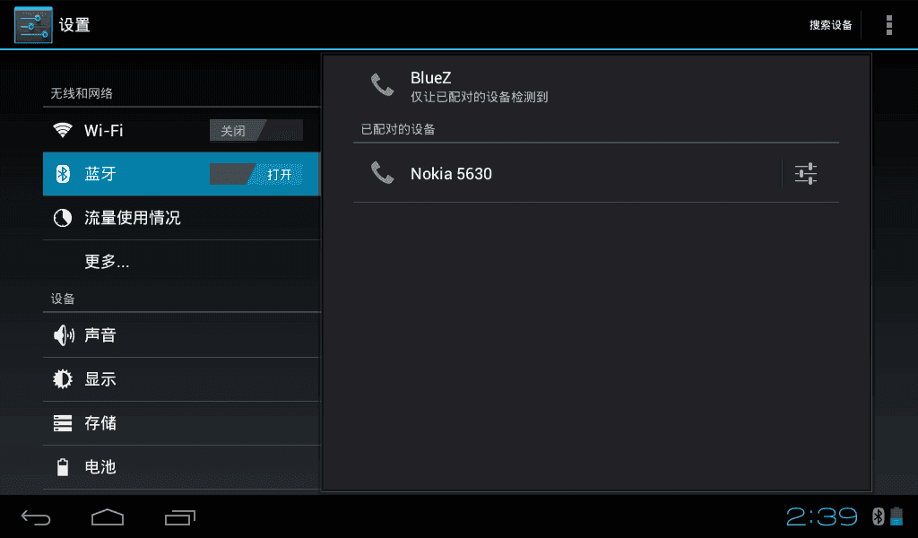

* Support for usb Bluetooth adapter to fix the Bluetooth headphone output

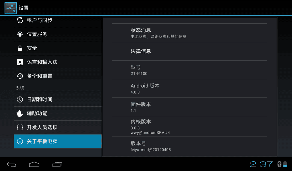

Updates:
- support for usb Bluetooth adapter
- Support for dm9601 card
- Built-in pl2303 module
- Built-tun module
- further optimization of the gravity sensor sensitivity, and amendments to the horizontal tilt
- optimize the partition size to increase the built-in storage space
- Improve the busybox support, titanium backup directly available

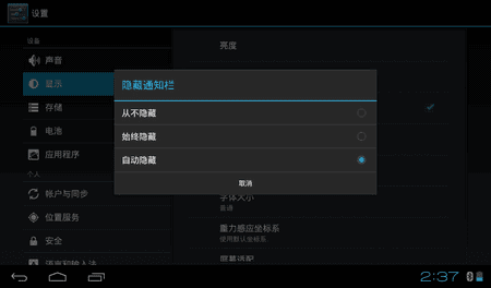

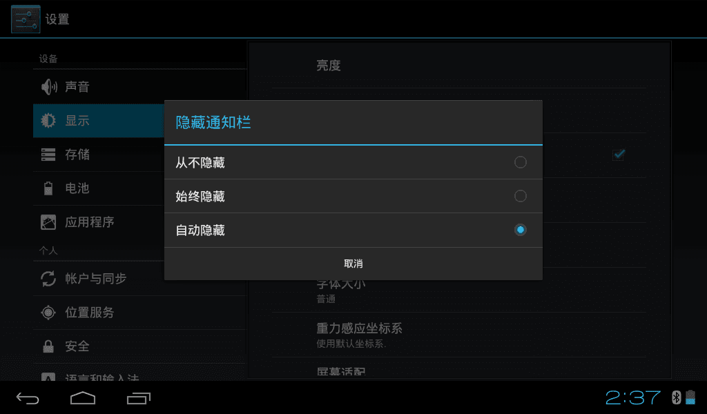

- update to hide the notification bar code, modify the settings
- native launcher to replace the starter, change the default wallpaper
- upgrade to the built-in fast Figure browse, play stores
- default brightness to 30%
Note:
- hide the notification bar is modified based on the a newuser2012 methods, and would like to acknowledge
- Brush complete access to the system for the first time is always hide the status bar mode, go to display settings according to their needs change
- gravity induction test on my machine, the basic perfect, but does not rule out the possibility that assembly and I different versions exist, refresh this version still does not resolve, that as many 1r07 version of touch, I do not have the equipment adjustment test, I am sorry, I can not do anything
- Aurora firmware update to this version, I think have been more perfect, I had envisaged to achieve full and hope that we can properly use version of the flight feathers suspended updates, thank you for your support!

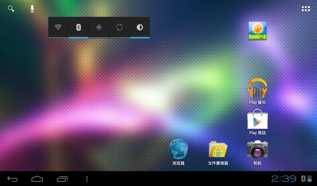

Ich bin begeistert.
Bis jetzt die beste Rom.

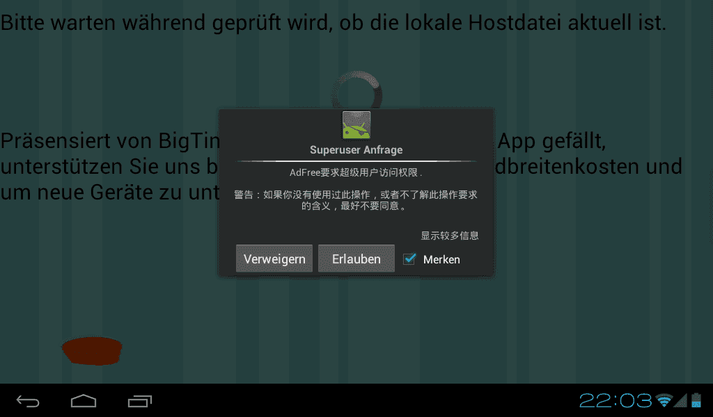

Bei mir habe ich KEINE Probleme mit dem Touchscreen. Läuft richtig schön flüssig.
Das einzige was mir bis jetzt aufgefallen ist.
