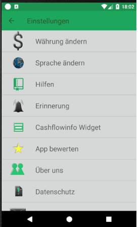

Sorry das ich kein Code hingeschrieben hab.
Einmal mein Layout:
<RelativeLayout xmlns:android="http://schemas.android.com/apk/res/android"
xmlns:app="http://schemas.android.com/apk/res-auto"
xmlns:tools="http://schemas.android.com/tools"
android:layout_width="match_parent"
android:layout_height="match_parent"
tools:context=".Einstellungen"
android:background="@color/background">
<include layout="@layout/toolbar"></include>
<ListView
android:id="@+id/lvSettingOptions"
android:layout_below="@+id/toolbar"/>
</RelativeLayout>
Hiermit fülle ich dann die Arraylist:
listView = findViewById(R.id.lvSettingOptions);
CashflowSettingsListAdapter settingsListAdapter = new CashflowSettingsListAdapter(this, getResources().getStringArray(R.array.settingOptions),
R.array.settingOptionIcons);
listView.setAdapter(settingsListAdapter);
Und hier meine Adapter Klasse:
public class CashflowSettingsListAdapter extends ArrayAdapter<String> {
private List<String> settingOptions;
private Activity context;
private TypedArray images;
private int iconArrayLength;
public CashflowSettingsListAdapter(Activity context, String [] settingOptions, int iconArrayId) {
super(context, R.layout.listview_item_settings);
this.context = context;
this.settingOptions = Arrays.asList(settingOptions);
images = context.getResources().obtainTypedArray(iconArrayId);
this.iconArrayLength = context.getResources().getIntArray(iconArrayId).length;
@override
public int getCount() {
return settingOptions.size();
@override
public long getItemId(int i) {
return 0;
@override
public View getView(final int i, View view, ViewGroup viewGroup) {
View row = view;
if(row == null) {
LayoutInflater inflater = context.getLayoutInflater();
row = inflater.inflate(R.layout.listview_item_settings, viewGroup, false);
TextView tvSettingsOption = row.findViewById(R.id.tvSettingsOptionText);
tvSettingsOption.setText(settingOptions.get(i));
ImageView ibSettingsOptionIcon = row.findViewById(R.id.ibSettingsOptionIcon);
if (images != null && i < iconArrayLength) {
ibSettingsOptionIcon.setImageResource(images.getResourceId(i, -1));
return row;
Liebe Grüße

Zu deinem Layout
zu dieser Zeile (android:layout_below="@+id/toolbar")
Ich hoffe das du nicht in dem Includeten Layout auch die Id mit + erstellst.
Eigentlich hatte mich auch dein ListItem Layout interessiert vor allen ob das auch im Querformat richtig angezeigt wird.
Es wären vielleicht noch Screenshots interessant wie das ganze aussieht und der komplette Code deiner Activity/Fragment. Und bitte in code tags, damit es besser lesen kann.

[doublepost=1533406711,1533405887][/doublepost]Sorry hat nicht richtig hochgeladen.
Hi schön das du den Code noch gepostet hast.
Mich würde aber interessieren ob das was ich dir gesagt habe geholfen hat.
Wie ich aus deinem Code sehe hast du die Änderungen noch nicht gemacht.
Ich dachte eigentlich ein Screenshot vom Problem, also da wo die Sachen doppelt zu sehen sind.
