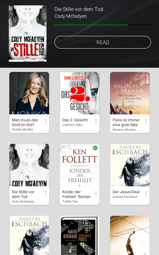

Sowas willste machen ? - Kommt aus meiner app
Kommt darauf an wie das umgesetzt ist :) In meinem Fall will ich nur Text anzeigen.
Wird das bei dir nach und nach reingeladen?

Hier als Anhaltpunkt das reycleView zum obigen screenshot.
(Nur copy & paste) damit du im groben nachvollziehen kannst
Code:
public class EPUBBookList_Adapter extends RecyclerView.Adapter<EPUBBookList_Adapter.MyViewHolder>
    private Context                         mContext;
    private List<EPUBBook_Struct> albumList;
    private OnClickListener       onClickListener;
    private int                         mCurrentMenuPosition = -1;
    public interface OnClickListener
        public void onClick(int position);
        public void onNeedReload(int position, Boolean refreshList);
    public void setOnClickListener(OnClickListener listener)
        onClickListener = listener;
    public class MyViewHolder extends RecyclerView.ViewHolder
        public TextView title, count;
        private String mItem;
        public ImageView thumbnail, overflow,checkreaded;
        public MyViewHolder(View view)
            super(view);
            title = (TextView) view.findViewById(R.id.title);
            count = (TextView) view.findViewById(R.id.count);
            thumbnail = (ImageView) view.findViewById(R.id.thumbnail);
            overflow = (ImageView) view.findViewById(R.id.overflow);
            checkreaded = (ImageView) view.findViewById(R.id.check_readed);
    public EPUBBookList_Adapter(Context mContext, List<EPUBBook_Struct> albumList)
        this.mContext = mContext;
        this.albumList = albumList;
    @Override
    public MyViewHolder onCreateViewHolder(ViewGroup parent, int viewType)
        LayoutInflater mInflater = (LayoutInflater) mContext.getSystemService(Context.LAYOUT_INFLATER_SERVICE);
        View itemView = mInflater.inflate(R.layout.epub_album_card,null);
        return new MyViewHolder(itemView);
    @Override
    public void onBindViewHolder(final ViewHolder holder, int position)
        EPUBBook_Struct album = albumList.get(position);
        final int pos = position;
        holder.title.setText(album.title);
        holder.count.setText(album.author);
        // loading album cover using Glide library
        if (album.coverurl.equals("default"))
            Glide.with(mContext).load(R.drawable.epub_nocover).into(holder.thumbnail);
        else
            Glide.with(mContext).load(album.coverurl).into(holder.thumbnail);
        if (album.percent.equals("100"))
            holder.checkreaded.setVisibility(View.VISIBLE);
            holder.checkreaded.bringToFront();
        else
            holder.checkreaded.setVisibility(View.INVISIBLE);
        holder.overflow.setOnClickListener(new View.OnClickListener()
            @Override
            public void onClick(View view)
            {  mCurrentMenuPosition = pos;
                showPopupMenu(holder.overflow);
        holder.thumbnail.setOnClickListener(new View.OnClickListener()
            @Override
            public void onClick(View v)
                if (onClickListener != null) onClickListener.onClick(pos);
                //Toast.makeText(mContext,"clicked="+ pos,Toast.LENGTH_SHORT).show();
INIT
Code:
  albumList = new ArrayList<>();
  adapter = new EPUBBookList_Adapter(act, albumList);
recyclerView.setAdapter(adapter);
//   Hier albumlist  füllen  / ändern
adapter.notifyDataSetChanged();
Reaktionen: deka
