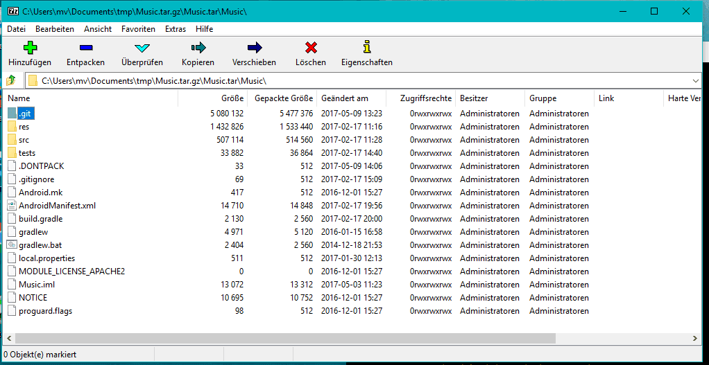

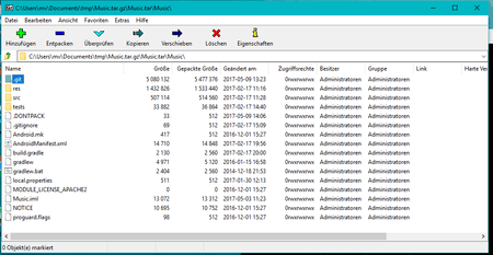

.DONTPACK  z.B.:
.gradle
.idea
gradle
build
*.apk
funktioniert mit cygwin und unter linux
mv@DESKTOP-0RVF56I /cygdrive/c/Users/mv/Documents/tmp
$ for i in *;do ./packFolder.py $i;done
.DONTPACK not found or not a directory
[Errno 2] No such file or directory: 'Music3/.DONTPACK'
[Errno 20] Not a directory: 'packFolder.py/.DONTPACK'
$ ls
Music Music.tar.gz Music2 Music2.tar.gz Music3 packFolder.py
$ ls -lh
total 11M
drwxrwxrwx+ 1 mv Administratoren 0 May 9 14:38 Music
-rw-r--r--+ 1 mv Kein 5.0M May 9 15:21 Music.tar.gz
drwxr-xr-x+ 1 mv Kein 0 May 9 15:13 Music2
-rw-r--r--+ 1 mv Kein 5.1M May 9 15:21 Music2.tar.gz
drwxr-xr-x+ 1 mv Kein 0 May 9 15:12 Music3
-rwxr-xr-x+ 1 mv Kein 940 May 9 15:21 packFolder.py
$ diff Music/.DONTPACK Music2/.DONTPACK
3d2
< gradle
$ ls Music3/.DONTPACK
ls: cannot access 'Music3/.DONTPACK': No such file or directory
