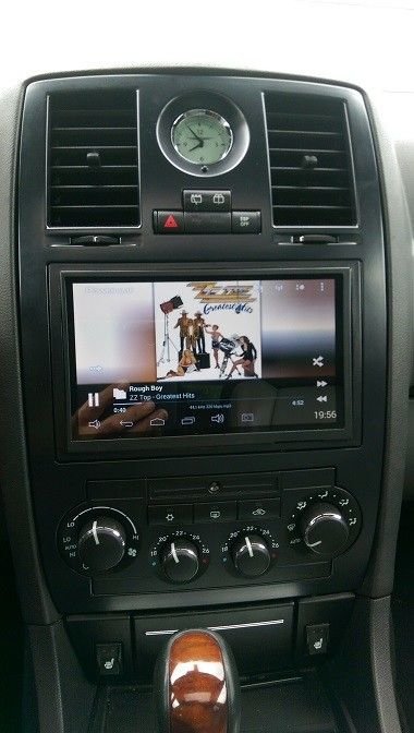

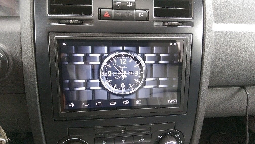

i bought myself a NU5002 (andriod) because of the 8" screen to put it in my Chrysler 300c.
took some time to make the bezel fit , but it looks fine now
the PAC interface took a few days to deliver in Europe,

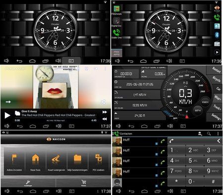

i didn't want to root/replace rom so i went with some other lauchers and now i use nova-launcher , which does the job for me
iám testing Sygid and Navigon as navigation, both work great[
i hooked up the Pac RP4-CH11interface, so i could use the steeringwheel buttons
in the key-editor i could read the can codes, so i use the short and long press option from the Pac interface
some codes are realy close to eachother so they could'nt be used but i manage to get 9 working , (there are only 6 buttons)
now i have "home" "play" and "mute" extra (home has double function in nova-launcher)
i needed "home" as button, because some apps are fulscreen and the 8"doesn't have the buttons on the side
"play" starts Power Player, because i stopped musicplayer in apps settings
hopefuly there comes a way to use "dailer" as the main phone app
next will be a front and a back camera

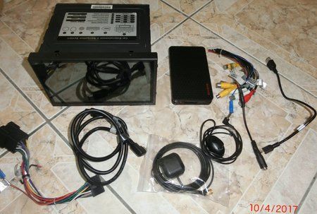

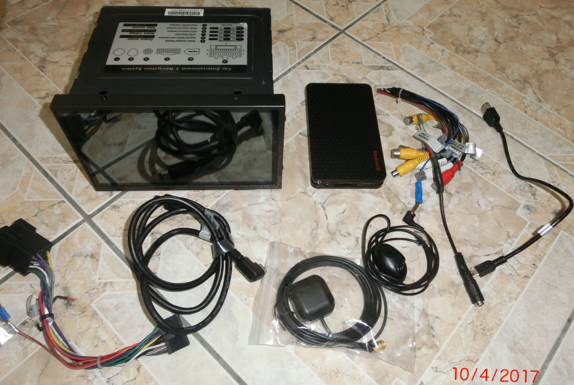

verkaufe mein Nu5002, wer Interesse hat melden. im gutem Zustand. Preis 299€
