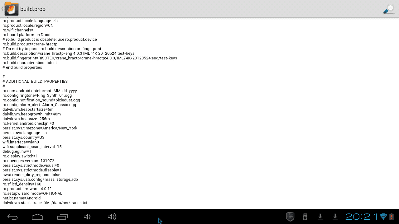

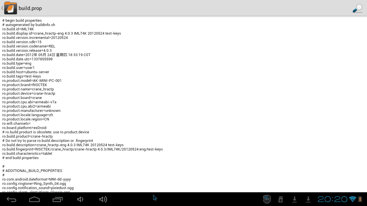

Hier ist die build.prop (copy/paste):
# begin build properties # autogenerated by buildinfo.sh ro.build.id=IML74K ro.build.display.id=crane_hractp-eng 4.0.3 IML74K 20120524 test-keys ro.build.version.incremental=20120524 ro.build.version.sdk=15 ro.build.version.codename=REL ro.build.version.release=4.0.3 ro.build.date=2012 05 24 18:33:19 CST ro.build.date.utc=1337855599 ro.build.type=eng ro.build.user=user1 ro.build.host=ubuntu-server ro.build.tags=test-keys ro.product.model=AK-MINI-PC-001 ro.product.brand=RISCTEK ro.product.name=crane_hractp ro.product.device=crane-hractp ro.product.board=crane ro.product.cpu.abi=armeabi-v7a ro.product.cpu.abi2=armeabi ro.product.manufacturer=unknown ro.product.locale.language=zh ro.product.locale.region=CN ro.wifi.channels= ro.board.platform=exDroid # ro.build.product is obsolete; use ro.product.device ro.build.product=crane-hractp # Do not try to parse ro.build.description or .fingerprint ro.build.description=crane_hractp-eng 4.0.3 IML74K 20120524 test-keys ro.build.fingerprint=RISCTEK/crane_hractp/crane-hractp:4.0.3/IML74K/20120524:eng/test-keys ro.build.characteristics=tablet # end build properties
# # ADDITIONAL_BUILD_PROPERTIES # ro.com.android.dateformat=MM-dd-yyyy ro.config.ringtone=Ring_Synth_04.ogg ro.config.notification_sound=pixiedust.ogg ro.config.alarm_alert=Alarm_Classic.ogg dalvik.vm.heapstartsize=5m dalvik.vm.heapgrowthlimit=48m dalvik.vm.heapsize=256m ro.kernel.android.checkjni=0 persist.sys.timezone=America/New_York persist.sys.language=en persist.sys.country=US wifi.interface=wlan0 wifi.supplicant_scan_interval=15 debug.egl.hw=1 ro.display.switch=1 ro.opengles.version=131072 persist.sys.strictmode.visual=0 persist.sys.strictmode.disable=1 hwui.render_dirty_regions=false persist.sys.usb.config=mass_storage,adb ro.sf.lcd_density=160 ro.product.firmware=4.0.11 ro.setupwizard.mode=OPTIONAL net.bt.name=Android dalvik.vm.stack-trace-file=/data/anr/traces.txt
Wo man da die Auflösung ändern könnte, erschließt sich mir nicht :confused:
Auf Wunsch auch als Screenshot: Ist übersichlicher, aber editieren wäre aufwändiger.
Hab mal einen Screenshot eines Full-HD-Videos gemacht, aber der Screen ist dort bis auf die Steuerelemente schwarz. Und hat die kleine HD-Auflösung :-(
Reaktionen: Nosferatu Alucard
Hier noch 2 Screenshots der build.prop.
Ok schade, es wird zwar lustigerweise eine LCD-Density festgelegt, aber keine Auflösung...
