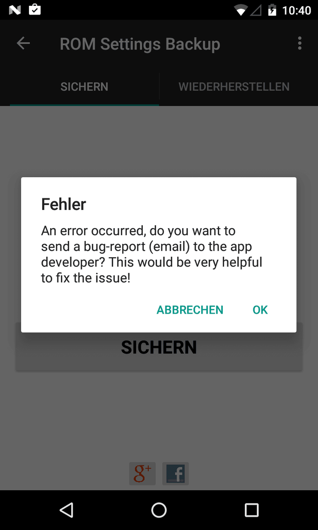

Beim ersten start hatte ich folgenden Fehler, die app ist aber nicht abgestürzt, konnte danach das Backup durchführen. (wiederherstellen habe ich noch nicht versucht)
Bugreport hab ich nicht gesendet, aber das stand im logcat:
02-03 10:40:08.340 5519 5561 E SettingsBackupError: java.lang.RuntimeException: An error occurred while executing doInBackground()
02-03 10:40:08.340 5519 5561 E SettingsBackupError: at android.os.AsyncTask$3.done(AsyncTask.java:325)
02-03 10:40:08.340 5519 5561 E SettingsBackupError: at java.util.concurrent.FutureTask.finishCompletion(FutureTask.java:354)
02-03 10:40:08.340 5519 5561 E SettingsBackupError: at java.util.concurrent.FutureTask.setException(FutureTask.java:223)
02-03 10:40:08.340 5519 5561 E SettingsBackupError: at java.util.concurrent.FutureTask.run(FutureTask.java:242)
02-03 10:40:08.340 5519 5561 E SettingsBackupError: at android.os.AsyncTask$SerialExecutor$1.run(AsyncTask.java:243)
02-03 10:40:08.340 5519 5561 E SettingsBackupError: at java.util.concurrent.ThreadPoolExecutor.runWorker(ThreadPoolExecutor.java:1133)
02-03 10:40:08.340 5519 5561 E SettingsBackupError: at java.util.concurrent.ThreadPoolExecutor$Worker.run(ThreadPoolExecutor.java:607)
02-03 10:40:08.340 5519 5561 E SettingsBackupError: at java.lang.Thread.run(Thread.java:761)
02-03 10:40:08.340 5519 5561 E SettingsBackupError: Caused by: java.lang.NullPointerException: Attempt to invoke virtual method 'java.lang.String com.google.android.gms.ads.identifier.AdvertisingIdClient$Info.getId()' on a null object reference
02-03 10:40:08.340 5519 5561 E SettingsBackupError: at com.adcash.mobileads.GpsHelper.getAdvertisingId(GpsHelper.java:29)
02-03 10:40:08.340 5519 5561 E SettingsBackupError: at com.adcash.mobileads.AdRequest.getURLParameter(AdRequest.java:388)
02-03 10:40:08.340 5519 5561 E SettingsBackupError: at com.adcash.mobileads.AdRequest$GenerateImpressionUrl.doInBackground(AdRequest.java:279)
02-03 10:40:08.340 5519 5561 E SettingsBackupError: at com.adcash.mobileads.AdRequest$GenerateImpressionUrl.doInBackground(AdRequest.java:267)
02-03 10:40:08.340 5519 5561 E SettingsBackupError: at android.os.AsyncTask$2.call(AsyncTask.java:305)
02-03 10:40:08.340 5519 5561 E SettingsBackupError: at java.util.concurrent.FutureTask.run(FutureTask.java:237)
02-03 10:40:08.340 5519 5561 E SettingsBackupError: ... 4 more
als "root" app verwende ich phhhs superuser, falls es damit zusammenhängen sollte (supersu ist keine option für mich)
Hi vetzki,
hattest du zu dem Zeitpunkt Gapps drauf?
Danke!
ja
Hallo Leute,
neues Update für ROM Settings Backup.
v2.42:
+ Werbung in Gratis-Version entfernt (war nicht stabil)
+ Ein paar backup and restore verbesserungen
@vetzki Das problem sollte geschichte sein
