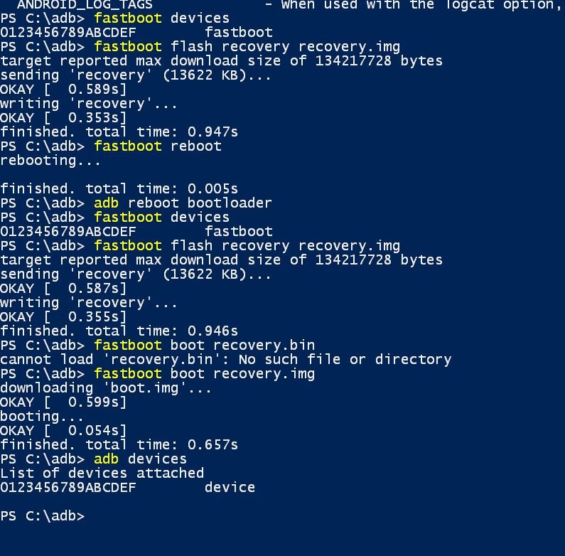

Kennt jemand eine narrensichere Methode, TWRP ggf. mit einem Flash Tool (Sp Flash, QGDP Assembly, MDT) auf das Bluboo S8 zu flashen und TWRP dann auch zu booten ohne immer im Standard Android Recovery zu landen?
Dazu habe ich bereits u.a. Anfrage im thread [ROOT] tutorial for root Bluboo S8 with TWRP in xdadevelopers eingestellt. (mit wenig Hoffnung auf Feedback). Es könnte aber auch ein produktspezifisches Problem sein.
"I am searching for a fool-proof method to load TWRP 3.1.1 into my recently purchased Bluboo S8a_V21_20170125. Loading TWRP with SP Flash Tool 5.18xx failed with message "PMT has changed... ". Phone unlocked to work with adb/fastboot. Loading TWRP by Fastboot worked ok, but could not be booted into TWRP, "fastboot reboot" rebooted the phone into normal op mode. I am afraid, I don't manage the above fix to work with my phone. Sometimes I manage to get into the Chinese (Recovery?) menu but when I hit <adb reboot recovery> I get an error message like "cannot connect to device..." or so. As of fanfan's advice to prepare the command <adb reboot recovery before I conclude that it has to be fired as soon as the 1. line of the chinese menu appears. Is this the trick? Whatever, the clue appears to booting into recovery before or without booting the phone. Attempting to change from fastboot mode to adb to go for: <adb reboot recovery> gave an error (... cannot connect... or so). Therefore I am desparately looking for
(1) some way to change from fastboot to adb after flashing the TWRP with fastboot to invoke <adb reboot recovery> or
(2) a detailed description of the flow of actions after successfully flashing TWRP into the phone.
Any clue?"

I.d.R. so:
- Flashen des TWRP
- sofortiges Starten über Vol+ Powerin den Recovery Mode (nicht vorher normal!)
oder
Im fastboot mit dem recovery img booten ohne es vorhar zu flashen)
fastboot< boot <image-reovery-datei auf dem PC>
.... hier liegt der Hase im Pfeffer: "- sofortiges Starten über Vol+ Powerin den Recovery Mode (nicht vorher normal!)" funktioniert weder mit Vol+ noch mit Vol-, vielleicht mit irgendeiner, mir unbekannten produktspezifischen Kombination von Vol+/- und Power.
"Im fastboot mit dem recovery img booten ohne es vorhar zu flashen) , fastboot< boot <image-reovery-datei auf dem PC>" interessant, nach dem erfolgreichen flashen des TWRP images führte <fastboot reboot> immer zum normalen booten. Also sollte ich
<fastboot boot TWRP.img> nach dem erfolgreichen flashen versuchen? Aber die TWRP.img Datei ist doch dann schon installiert? Versuche ich heute nachmittag, danke!
Nein, das booten aus dem fastboot mode mit dem Aufruf: boot ...
Erfordert kein vorheriges Flaschen!

Code:
<fastboot boot <TWRP recovery Datei auf dem PC>
So sollte das funktionieren, falls es das Phone beherrscht.

1. SM in den fastboot mode starten
2. mit PC verbinden
3. auf dem PC cmd Fenter fastboot starten
Code:
C:\Program Files (x86)\Minimal ADB and Fastboot>fastboot boot recovery.bin
< waiting for any device >
Poste mal das von dir...

1. Das TWRP Image muss genau für das Phone sein
2. beim entsperrten Bootloader und korrektem Image braucht man nicht Flaschen, sondern kann mit dem fastboot Commando boot ... direkt booten
Also viel Glück.
(1) "Das TWRP Image muss genau für das Phone sein." Klar, allerdings offizielles TWRP gibt es nicht, mein Custom TWRP_3.1.1 für Bluboo S8 soll funktionieren, kann über adb/fastboot auch geladen werden, <fastboot reboot> führt zum normalen Start des S8 und wahrscheinlich zum Überschreiben des TWRP. Keiner (im Netz) sagt wie genau wie TWRP für S8 zu starten ist. Russische Informationen auf 4pda kann ich leider nicht lesen.
(2) fastboot help beschreibt den befehl <fastboot boot> wie folgt: "boot <kernel> [ <ramdisk> [ <second> ] ] ... download and boot kernel", keine Ahnung wie das konkret für <recovery> auszuführen ist.
Leider funktioniert der einfache SP Flash Tool 5.1828 nicht, liefert immer: "PMT has changed the ROM (oder so ähnlich)... use download and format all" dann produziere ich bestimmt einen Brick. Ich experimentiere noch (bis zum Brick...).

Du solltest so vorgehen:
- kopiere das twrp-image am besten in das Verzeichnis, aus dem du das fastboot Commando auf dem PC startest.
Dann wie schon beschrieben:
Fastboot Boot <dateiname des TWRP>
Dann sollte das SP in den TWRP booten.

... danke, Deine Antwort ist Balsam für die frustrierte Seele (immerhin habe ich noch keinen brick). Also: o.a. Vorgehensweise habe ich in der Abb. unter #15 bereits durchgeführt und dokumentiert: TWRP image als "recovery.img" in den adb/fastboot Ordner kopiert, geflasht und dann gebootet, alles als "ok" bestätigt, aber anstatt ins TWRP zu booten ist das SP normal gestartet... Schei...!
Nicht das TWRP flashen, sondern mit dem image im fastboot booten!

Für mich bleibt offen, warum der Boot Versuch aus dem fastboot:
Code:
Mit dem Fehler:
Code:
not such file or directory
endete.
