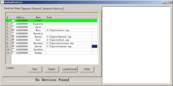

8. Next step is to open the “AndroidTool.exe”.
1-jpg.503344
9. The bottom should display “Found One LOADER Device”.

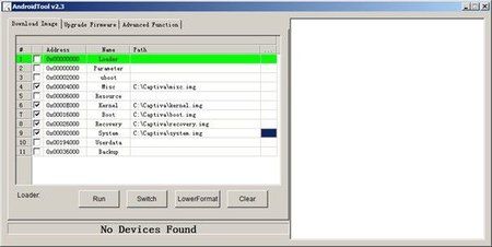

10. You need to deactivate the “Loader”, “Resoruce” and “Parameter” in the Tool.
11. Next you change the path of “Kernel”, “Boot”, “Misc”, “Recovery” and “System”.
12. Just doubleclick on the Path to change it manually or click on the right field of the changing part and a pop-up windows displays your windows explorer, so you get manually the way through the explorer to the extracted file from our downloaded file.
2-jpg.503345
13. I deleted the not necessary parts in my example. Even don’t wonder of the “No devices found”, because I did connect the captiva tablet to my computer for the tutorial.
14. After you changed everything like on my screenshot (Folderpaths can be different), click on “RUN”.
15. The tool will copy every IMG to the tablet.
16. After it finished your tablet should start again.
