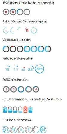

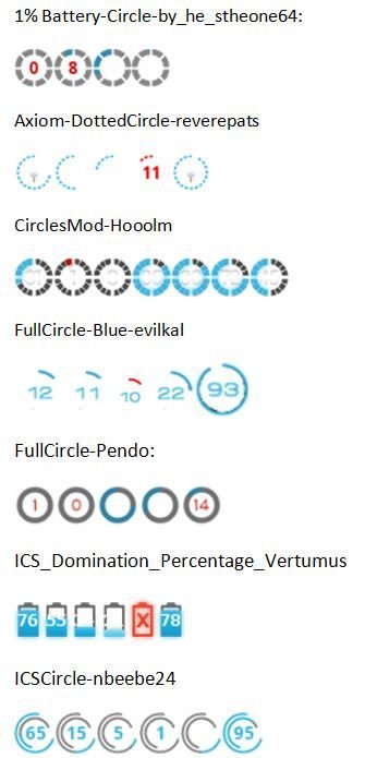

Wer Interesse hat
Batterie Mods für CM9
Originalthread: XDA
1% Battery-Circle.zip
Axiom-DottedCircle.zip
CirclesMod-Hooolm.zip
FullCircle-Blue-evilkal.zip
FullCircle-Pendo.zip
ICS_Domination_Percentage_Vertumus.zip
ICSCircle-nbeebe24.zip
Instructions :
Reboot in recovery
Flash the Zip
Check the battery display setting. (Settings - Interface - System - Status Bar - Battery status style -> Icon (default))
INSTRUCTIONS: To RESTORE the backup.
A flashable ZIP file is created during flashing of the battery mod. This is a backup of your original SystemUI.apk file. Each ZIP is timestamped with the date and time in GMT/UTC. All you have to do, is flash this ZIP as you would any other flashable CWM zip file. The files are located in \SDCard\UniversalFlasher\
