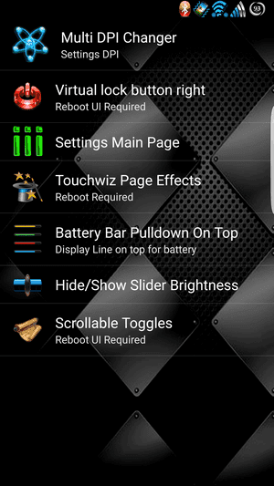

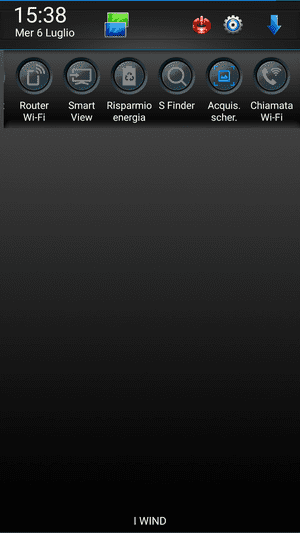

Added Hide/Show slider brightness in pulldown
Added how many toggles you want scroll in pulldown ... 5 to 20
