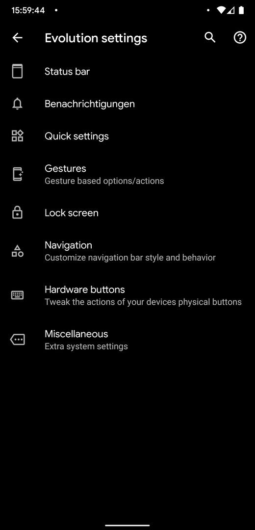

Besonderheit: Es hat ein eigenes Einstellungsmenü!

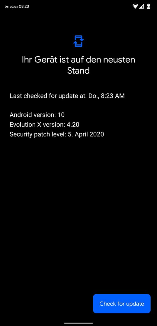

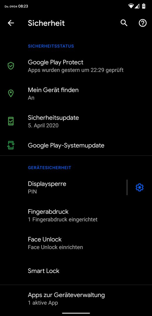

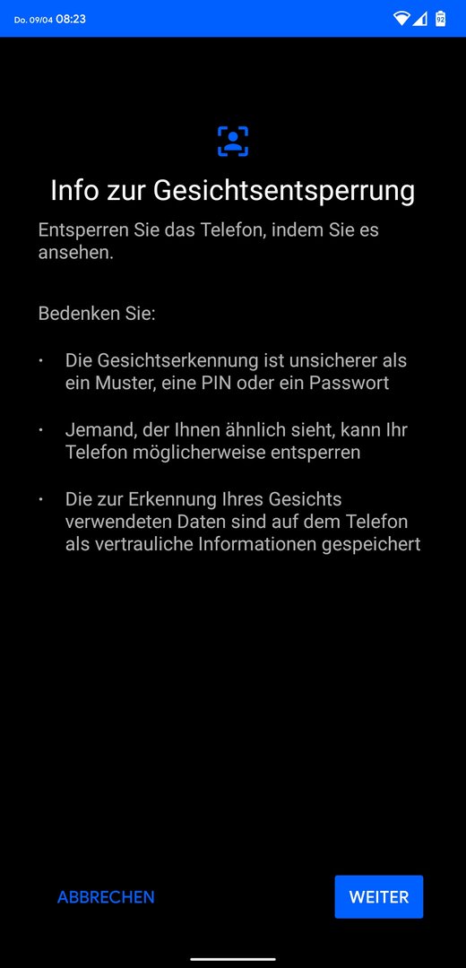

Besonders interessant ist das rot markierte...
Seit heute mit IRFaceunlock...
Siehe screens....
Hier der neuste Link:
https://sourceforge.net/projects/ev...lium-10.0-20200409-0325-OFFICIAL.zip/download
Changelog:
// Changelogs //
Device Changes:
- Kernel upstreamed to 4.9.218
- Updated to Coral's april 2020 build fingerprint
- Enabled iR faceunlock (Selinux is enforcing kek)
- Addressed some selinux denials for iR faceunlock
- LOS upstream
ROM Changes:
- Merged April Security patch (r33)
- Ported faceunlock feature (Thanks to @PixelExperience team)
- Updated OP faceunlock to V2.3.0
- Updated rom banner color
- Added outline style to caffeine qs tile drawable
- Disabled some whacky LS clock animations
- Updated some strings in qs panel
- Allow to show music headsup on new tracks
- Added improved kill-app api
- Some theming fixes
- Implemented edge long swipe gesture
- Ome more misc fixes
- Some more misc changes
