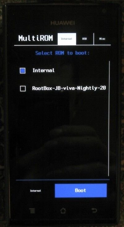

MultiROM is a multi-boot, originally developed by fellow Tasssadar for Nexus 7.
Makes it possible to install additional drivers to your Android device.
MultiROM can download the firmware from the internal memory or an external USB drive.
MultiROM in general is one giant hack and there is a chance that something will go wrong.
So always make a backup of your data.
In the current version of the firmware is made extra to the internal memory of the device (/ data/media/0/multirom /)
This must be considered during installation, especially users of P1 with a small amount of internal memory.
Flashing AOKP / CM on average only need 500MB for installation.
Fixed a naked AOKP - 450MB
Installed MIUI 5 - 650MB
Installed firmware must be in the format Zip CWM Update and based on the same branch of the nucleus.
Or more simply - if the main firmware JB - firmware-based ICS would not work.
DLOAD stock firmware is not supported.
Most likely you have this working without a problem if:
1. The installed firmware is now CM10.1 or PAC-Man.
2. Rekaveri CWM 6.x or TWRP
3. Free space in / data> = 1GB * of dop.ROMov
4. The device is not encrypted (if you do not know what it was about - most likely the way it is
Installing MultiROM
Download multirom and modified TWRP rekaveri
xep.8800.org/u9200/multirom/TWRP_2.5.0_MultiROM-P1.zip
http://xep.8800.org/u9200/multirom/multirom_v10_P1.zip
Install both files through CWM, the order is not important.
Done!
Installing dop.proshivok
In recovery go to the item Advanced -> MultiROM -> Add ROM. All settings are fine. Click Next and select the zip with the firmware. Install.
Knurl GApps'y and off zip, clean caches and so forth on dop.proshivkah this:
Advanced-> Multirom-> List ROMs where select the ROM, and then a menu appears with options to clear caches, install zip and so forth.
If you have updated the main POM:
MultiROM can recover through rekaveri Advanced-> MultiROM> Inject curr.boot sector or firmware multirom zip
Enjoy!
