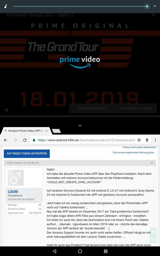

[doublepost=1543432572,1543432435][/doublepost] Screenshot_2018-11-28-20-15-13-581.jpeg
