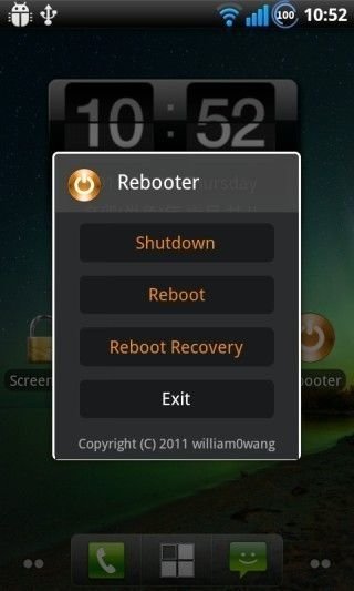

  • New Batter circle icon.
  • Remove Music Player buttons in drop down notification bar
  • Add Reboot app to power off, reboot and reboot to recovery
