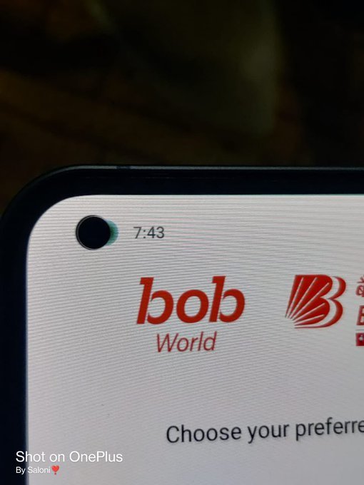

This is something called “Gray Uniformity”. Essentially what it is - is a voltage differential between all of the pixels on the screen. Basically some pixels respond at different voltages than others and produce more or less light accordingly. When they produce a calibration at the factory it attempts to compensate for this... but it can only help so much. It only noticeably affects the display at low brightness levels with certain colors (typically gray, hence the name “gray uniformity”).
The good news is that it won’t ever change or get worse (at least not within the usable lifespan of the display).
The bad news is there is really nothing you can do to fix it, besides swapping out the phone. This is what we call the screen lottery - you either get superb hardware, or less good hardware based on sheer luck. The DC dimming option has an influence on the voltages that run through the OLED panel, so that could reduce the green tint in gray uniformaty. But you might be facing different issues then, such as black crush, incorrect color display or other calibration abnormalities.
Generally though, the more expensive the phone, the less uniformity issues (this isn’t a solid metric of course, you can still get a 'terrible' screen on an expensive phone).
As to why it is allowed to happen—these OLED panels are typically produced on huge OLED sheets and they cut the screens out (like a sheet of dollar bills or paper). Screens near the edge of the sheet typically show more uniformity issues. At that point the ones that aren’t triaged are typically shipped to various vendors at various pricing, where the screens near the center are more 'pure' and thus more expensive. I can't make any claims about which OLED panels Oneplus buys as I have no connections to their factories or purchasing methods, but the Oneplus 7T did get quite some media attention because of poor gray uniformity as most of you know.
Some people will find the green tint a dealbreaker, while others barely notice it or don't find it disturbing. My personal opinion is irrelevant, but I will say that at this price point I do think that some screens should not pass through QA. But do please also note that nearly all OLED panels have some form of gray uniformity issues - ranging from smartphones to TVs. It's very difficult, and perhaps even impossible, to get the 'perfect' OLED screen.
