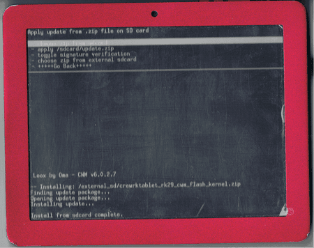

Nice! Thank you. I have tested it but... no success... Recovery showed this:
Finding update package...
Opening update package...
Installing update...
assert failed: getprop ("ro.product.device") == "rk2918" || getprop ( "ro.build.product" ) == "rk2918"
E:Error in /emmc/download/kernel-original.zip
(Status 7)
Installation aborted.
I changed zip filename to "kernel-original" as you can see... I used winrar. I need some help.

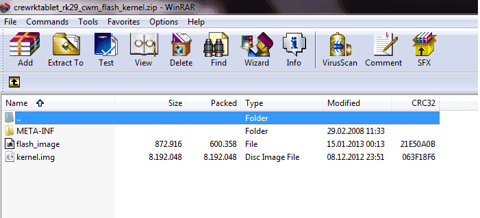

The kernel file inside must named kernel.img.
:thumbup:
:thumbup:
Yeah Oma... I have overwritten it and tablet showed that error... Has it to be signed? :confused2:
OK, what is your kernel?
:thumbup:
Reaktionen: lmemperador
It's the kepler 2 kernel.
JK-kernel_308_bq-kepler2_201301121601_JB
:thumbup:

JochenKauz schrieb:
Yes, JB will change it every time.
Gesendet von meinem Odys-Q mit der Android-Hilfe.de App
Bad luck! Well, at least we have no frills CPU... :D
djkail schrieb:
Same message... it didnt work.
Can't reproduce this fault on my hardware. No idea why this won't work with you. Sorry.
:thumbup:
