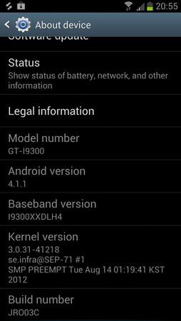

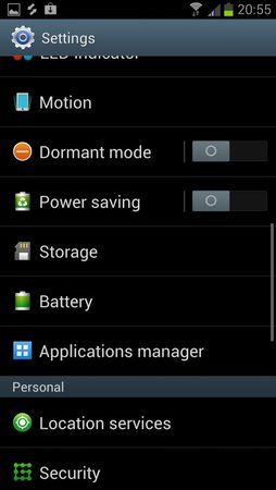

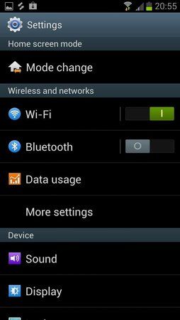

I9300XXDLH4
Base Firmware: I9300XXDLH4 (4.1.1)
Modem: I9300XXLH1
CSC: I9300OXADLH4
Change List: 41218
Datum: 2012-08-01
I9300XXDLH4---> Austria, Belgium, France, Germany, Hungary, United Kingdom
