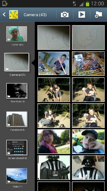

Problem gelöst ! so geht es Perfekt ! Getestet mit DLI5
What I did was delete secgallery2 and secgallery2 odex and Samsungcamera odex,
reboot into recovery,
wipe cache,
wipe dalvik,
flash zip,
wipe cache again,
wipe dalvik again,
fix permissions,
reboot and everything should be good to go.
