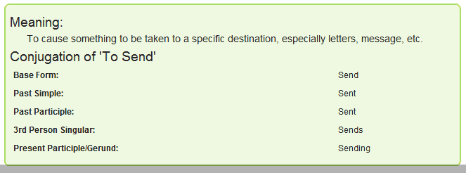

Ist zwar OT, aber:
Could you please please pretty pretty please correct your signature? ;)
