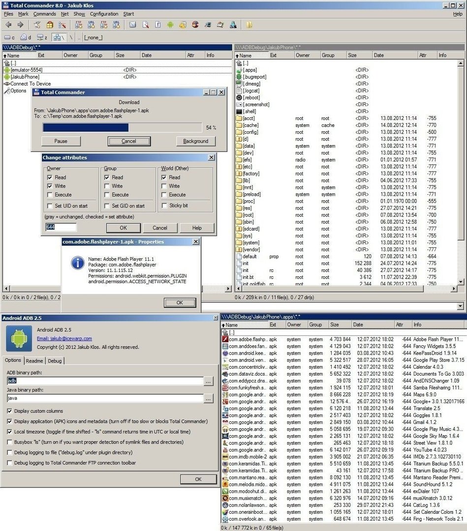

Kannst die auch mal dieses Plugin ansehen für Total Commander --> Android ADB.
Geht wunderbar!
Android ADB 4.6
Android ADB
The ultimate Android Total Commander file system plugin with extra features:
- Apps management (Install, Uninstall and Backup your apps)
- APK icons and metadata with custom columns
- Backup and Restore on ICS
- LogCat/BugReport/Dmesg (Copy file from folder), Shell
- Reboot menu with (Reboot, Hot Boot, Recovery, Download and Power Off)
- Screenshots (Copy file from .screenshot folder)
- Multiple devices with device rename functionality (friendly name)
- Bookmarks and WiFi auto-connect
- Rooted, semi-rooted and non-rooted devices
- Full unicode support
- x32 and x64 support
- TC command line integration
- Background copy/move
- Owner and Group custom columns
- Full file system management (download/upload recursive directories, copy, delete, rename, move, edit, view, overwrite confirmation and more)
- Copy/Move between 2 devices
- Set/Get file attributes/permissions - Change Attributes action in Total Commander
- ADB USB and wireless ADB (no need to install Android SDK)
- Auto mount support
- Debug logs
- Rich settings
Please, leave your comments, suggestions and bug reports in the plugin discussion page.
Requirements:
- Enabled "Android debugging" on your device
- Device connected to USB with proper drivers (an ADB device must be listed in Windows Devices)
- WiFi ADB (a rooted device with the "WiFi ADB" app downloaded from Google Play)
Category: TC File System Plugins
Status: freeware
Author: Jakub Klos
Added: 13.07.2012
Updated: 23.10.2012
Downloaded: 17380 times
» Download (x32, x64) | Discuss on TC forum
