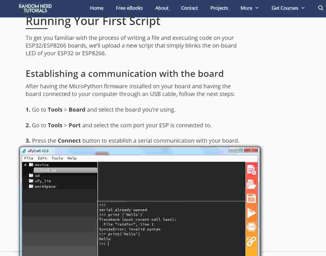

let’s take a closer look at each section of uPyCraft IDE:
Folder and files
Editor
MicroPython Shell/Terminal
Tools
1. Folder and files
This section shows several folders and files. The device folder shows the files that are currently stored on your ESP board. If you have your ESP32 or ESP8266 connected via serial to uPyCraft IDE, when you expand the device folder, all files stored should load. By default, you should only have a boot.py file. To run your main code, it is recommended to create a main.py file.
boot.py: runs when the device starts and sets up several configuration options;
main.py: this is the main script that contains your code. It is executed immediately after the boot.py.
Das klappt also - wie man an dem Bild sieht ...
