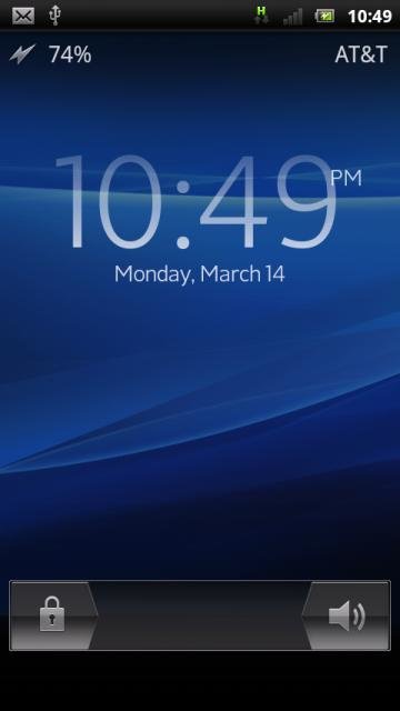

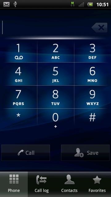

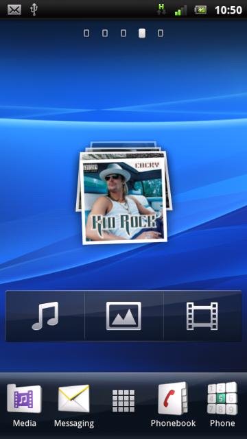

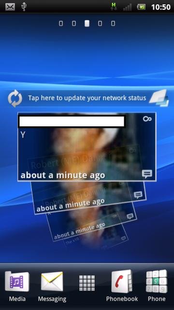

  • added arc status bar and icons and other arc visuals
  • added Phoene in settings to change status widgets
  • think I fixed blinking blue light
  • added auto mount to apps
  • after i reinstall timescape spline, phone and messaging works in timescape still cant get fb to work
