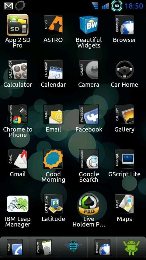

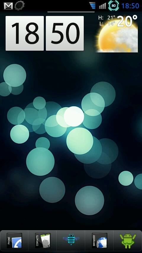

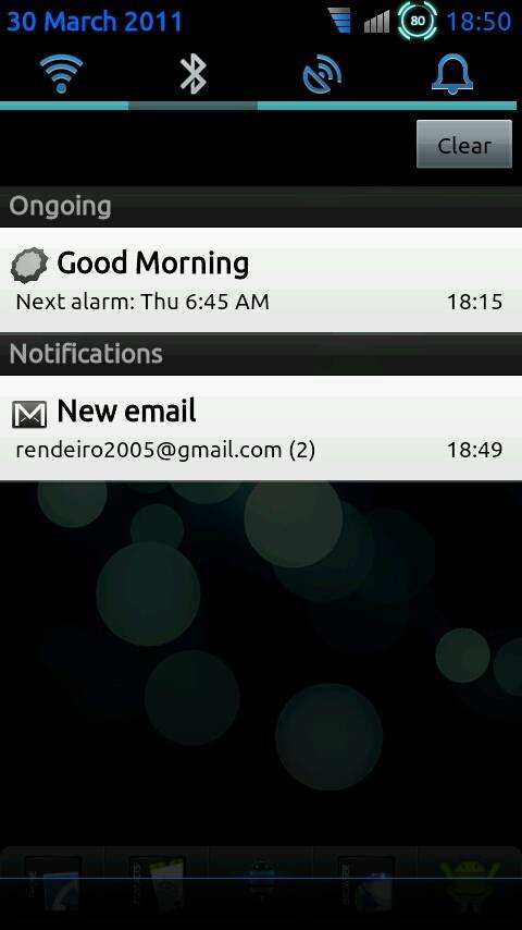

[MOD/ROM]scamble_v01.3[CM6.1.3][12thAPR] - new kernel on 2nd post
This is my latest MOD/ROM based on Froyo with CM6
and based on my previous one (check HERE if didn`t know that one yet).
YOU SHOULD INSTALL THIS THROUGH xRecovery.
IF YOU`RE NOOB AND DON`T KNOW WHERE TO START PLEASE GO HERE.
Special thanks to go3asy for his work HERE
SUPPORT
All basebands supported thanks to cobrato
If you`re on baseband .49 or .52 please install THIS patch (right after flash rom without reboot);
If you`re on recent ones .5x just go ahead.
INCLUDED/CHANGES
- Complete remodeling from my previous one;
- ADW;
- Astro File Manager;
- Chrome 2 Phone;
- Good Morning;
- GScript Lite;
- Torch;
- XDA;
- Ubuntu fonts;
- Blade WiFi;
- Flash Player;
- MIUI animations;
- MIUI keyboard;
- Wipe all unnecessary files;
- Camera (latest tweaks available/redesign);
- Contacts (redesign);
- Gallery (redesign);
- mms (redesign);
- Phone (redesign);
- Settings (redesign).
note: if any of these are payed apps please pm me and i`ll remove them ASAP.
INSTRUCTIONS
YOU MUST FOLLOW ALL STEPS TO EVERYTHING WORK AS IT SHOULD!!!
- Make a backup (if you want to);
- Factory Reset (Full Wipe);
- Wipe cache partition;
- Wipe Dalvik Cache (Advanced options > Wipe Dalvik Cache);
- Install [MOD/ROM)scamble_v01[CM6.1.3].zip;
- Install fix from 2nd post
- Reboot;
- Let him reboot one more time and you`re donne;
- Go to Settings > CyanogenMod Settings > User interface > Tweaks extras > Select a theme > scamble;
- Press Menu > More > ADWSettings > Backup & Restore > Restore ADW Settings & Desktop (then make your own changes);
- Go to GScript Lite > Menu > Add Script > Load File > add-on_installer > Save > Run;
- Repeat the same process but instead of add-on_installer, choose reboot_recovery;
- Donne. Enjoy
