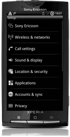

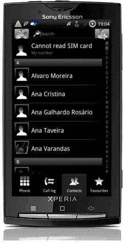

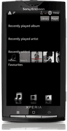

[ROM] 2.2.1 [REL 11-04] TripNMiUI FINAL 1.0.3
Quelle: XDA
Autor: rendeiro
Link: [ROM] [MAR29] [2.1]MOD_Cleaned_Rom[v02b]2.1.1A.0.16
Dies ist eine Stock ROM, basierend auf der neuesten Firmware, und dem neuesten Baseband für das Sony X10.
Die ROM wurde von allem Sony-Ballast befreit, und optimiert - und als Black Edition zum Download gestellt.
2.1.1A.0.16 und BB 58

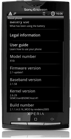

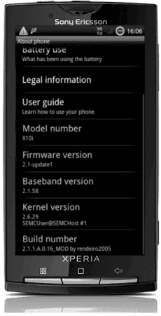

by rendeiro2005's request, this is a new thread for version 2b (b for bub). this version has some minor installation fixes, the black android keyboard set to default for a better match to the black theme, and some additional updates to the hosts and apn file. in addition, the latest Z's jit2, J's freexperia recovery, and busybox 1.17.2 are present w/ polish provider customizations removed. all else is as rendeiro2005 created in version 1.

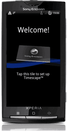

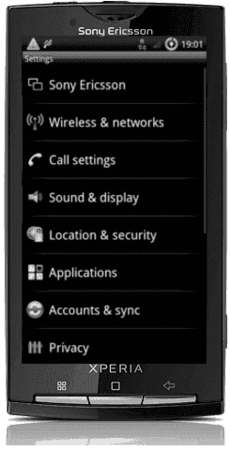

Hi all
This is a moded rom from SE based on 2.1.1A.0.16 firmware.
A big thanks to subhankar.ds for let me use his theme on my mod
Idea
My idea was to give you an android 2.1 SE firmware almost completely cleaned from junk.
This is already with JIT, Sysctl and blá, blá, blá. you know the rest
Introduction
This was based on 2.1.1A.0.16 with the latest baseband available (2.1.58) now.
Don`t know if this will work on any other .5x baseband (i think so, but...).
If you had any doubt about that, please flash your phone through Flashtool the 58 baseband.
Removed/Added
It`s simpler to tell what remains or added
- ADW as launcher (added);
- AnReboot (added);
- Astro File Manager (added);
- SE Browser;
- Calendar;
- Camera;
- Email;
- Facebook;
- Gmail;
- Latitude;
- Maps;
- Market;
- Mediascape;
- Messaging;
- Navigon;
- Phone;
- Phonebook;
- Places;
- RealCalc (added);
- SpareParts (added);
- Superuser (added);
- Sysctl pre-installed and tweaked (added);
- Talk;
- Timescape;
- VoiceDialer;
- XDA app (added);
- YouTube.

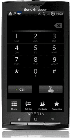

DOWNLOAD:
all wipes & install via XRecovery install custom zip

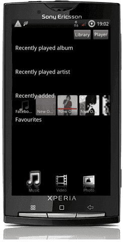

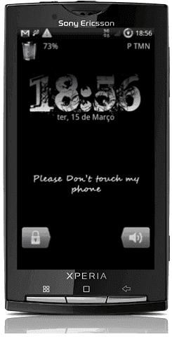

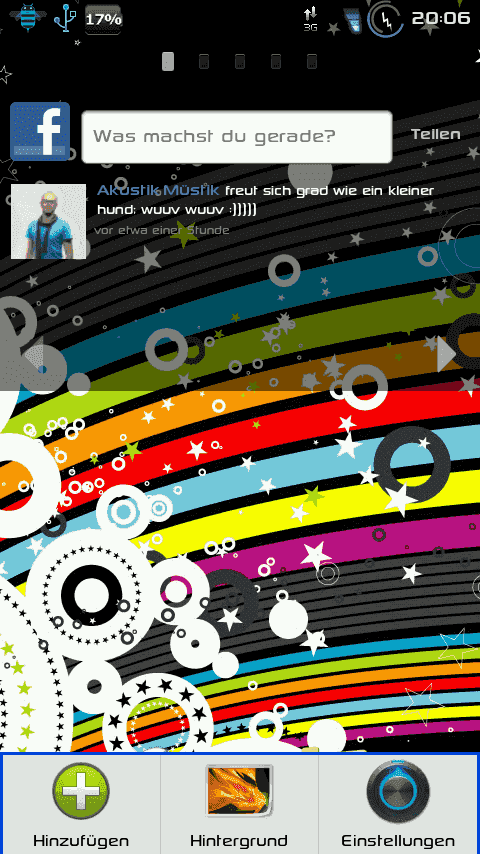

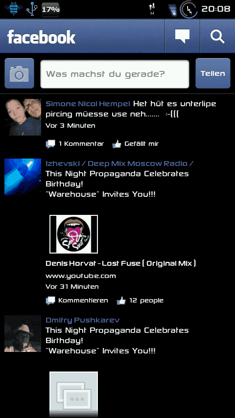

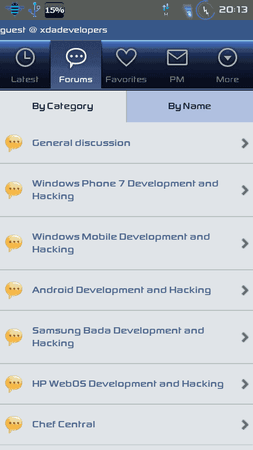

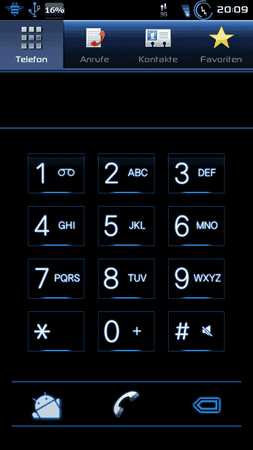

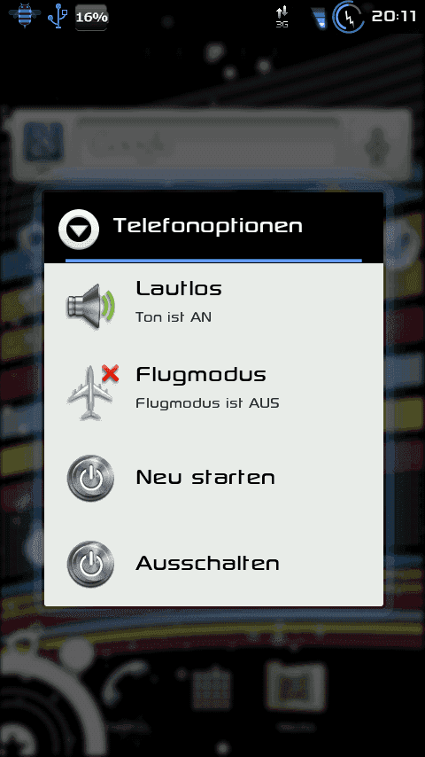

ich möchte mal eben meine bisherige Erfahrung mit dieser ROM mit euch teilen.
Dazu habe ich den Custom-Kernel installiert, durch welchen zwar App2SD nicht mehr möglich ist, aber alles um einiges flüssiger läuft.
Zu empfehlen ist Baseband 49.
Erster Eindruck nach dem Starten:
Wirklich sehr smooth laufende Optik (besser als bei den anderen aktuellen 2.2 Roms, meines Erachtens). Alles im Design des Iphone gehalten.
Was mich wirklich überrascht: Auch die Einstellungen sind die des Iphones. Sehr viel umfangreicher, nett gestaltet. Gewöhnungsbedürftig, aber es macht Spaß durchzublättern. Auch die Kontextmenüs sind nun anders.
Es gibt Launcher-Optionen sowie ein anderes installiertes Theme (Cartoon-Optik). Widgets verschiebt und löscht man auch auf andere Weise, nicht mehr wie beim gewohnten Android. Der Bounce-Effekt ist sehr gut gelungen. Jedoch, wenn man aufwändige Übergangs-Effekte für den Homescreen einstellt (z.B. 3D-Box oder rotieren), dann neigt der Homescreen zum ruckeln. Aber mit klassischer Einstellung oder nicht überspektakulären Effekten läuft es extrem flüssig!
Kontaktbuch usw. alles im Iphone-Stil.
Ein übersichtlicher Dateimanager sortiert alle vorhandenen Dateien auf der SD-Karte nach Arten, wie APKs, Bilder, Musik, Video, usw.
Alles in allem auf den ersten Blick echt gelungen!
Auf den zweiten Blick habe ich ein paar Mängel gefunden. So ruckelt es ein wenig in der MIUI-Galerie, wenn man die Bilder hin- und herschiebt, das nervt durchaus. Es gibt leider auch keinen "Launcher", in dem man dann alle Programme wiederfindet. Diese sind alle über die Homescreens verteilt (Edit: Man kann alle Programme in einen Ordner stecken, somit bleiben die Homescreens frei).
Es funktioniert aber eigentlich alles einwandfrei (bis auf das Kameralicht, irgendwie will das bei mir nicht).
Was ich schade finde: Der Lockscreen bietet zwar jede Menge unterschiedliche Designs, allerdings funktioniert nur die Entsperr-Funktion. Es sind Symbole für Telefon und SMS gegeben zum schieben/ziehen, allerdings entsperrt er dann nur das Display und öffnet keine Anwendung. Der Lockscreen färbt sich rot, wenn die Batterie langsam leer wird (ab 15%). Dazu gibt es einige Energiespar-Optionen im Menü, welche ich noch nicht probiert habe.
Da die gesamte Optik nun nicht mehr nach Android aussieht, habe ich mich gefragt, ob man denn noch gewohnte Launcher installieren kann.
Gefragt, getan:
LauncherPro Plus installiert:
Funktioniert nach wie vor einwandfrei, auch die Übergänge sind wesentlich smoother als sonst (sehr schnell, flüssig, einfach nur lecker). Lediglich die Statusbar gönnt sich einen schwarzen Hintergrund - mit dem MIUI-Launcher ist sie transparent. Stört aber nicht!
Nun lassen sich wie gewohnt Apps auf den Homescreen ziehen, der Launcher lässt sich wie gewohnt öffnen, etc. -> wie gewohnt! (Lediglich die Einstellungen sind nicht Android-Like). Die Android-üblichen Fenster werden aber alle englischsprachig dargestellt (wie z.B. beim APK-Installieren, "install", "done", "open" und so weiter). Mich stört das nicht.
Auf den MIUI-Homescreen lassen sich auch Widgets wie Beautiful-Widgets platzieren, es gibt also keine Einschränkungen mit dem MIUI-Launcher.
Was ich schade finde, ist, dass die Android-Gallerie nicht installiert ist. Diese läuft wesentlich flüssiger (bis jetzt mein größtes gefundenes Manko). MIUI Kamera und Co. funktionieren (bis auf Licht).
Alles in allem bin ich positiv überrascht. Da ich die ROM noch nicht lange nutze, kann ich nichts über Akkulaufzeit und andere Schwächen sagen. Werde dies aber nachholen!
Eventuell nehme ich morgen mal ein kleines Video auf und lade es bei Youtube hoch, um euch zu zeigen, wie es so läuft.
Bis dahin,

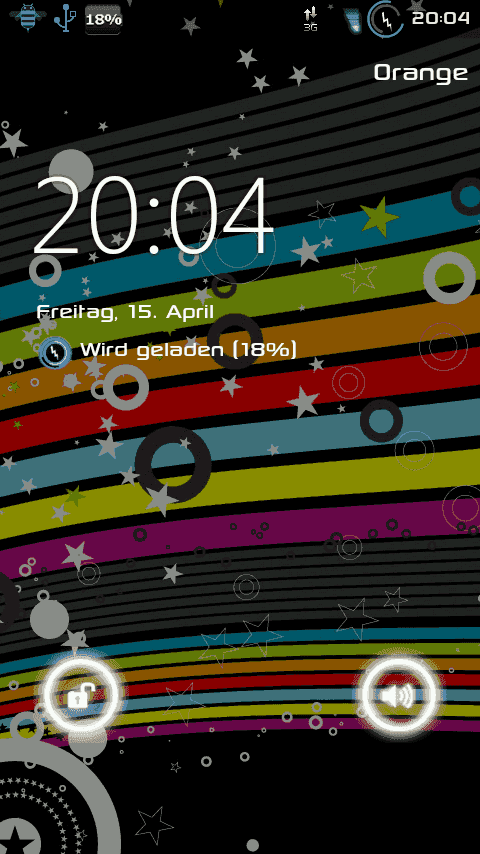

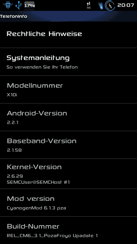

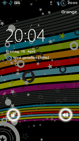

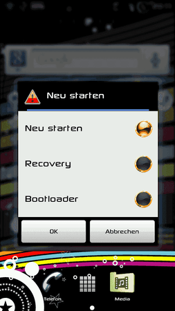

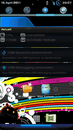

REL_CM6_3.1_PzaFroyo_update1
latest Xperia ARC Style [Mod] Xperia ARC Home Launcher
Hardware Led working
MIUI Keyboard
MIUI Animations
Gapps already included
Transparent Statusbar (Graustich)
[Mod ]framwork-res (mix aus Froyo/ Gingerbread & Honeycomb)[/B]
TWEAKS INCLUDED:
- [BL] Kifno Tweak's Universal Script v0.1 - Thks to kifno
- Fugu Tweaks
- sysctl
Build.prop Tweaks
Works on 54/55/58 Baseband
Download:[REL_CM6_3.1_PzaFroyo_update1.zip]

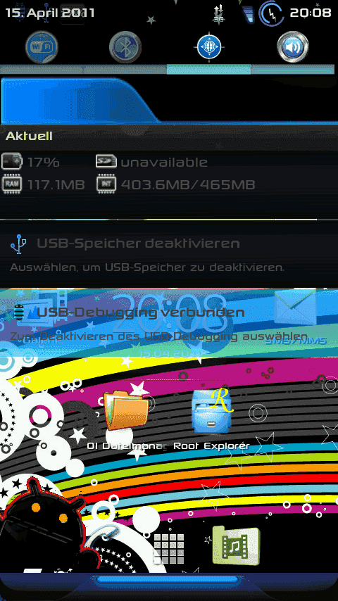

New 21.04.2011: Update2
ChangeLog und Vorgehen siehe Anhang
Instruction:
1.Herunter geladenes zip auf sdcard verschieben > Telefone ins xrecovery booten,
mach ein full Factory reset/ Wipe Cache Partition und Wipe Dalvik Cache unter advanced option.
2.Wähle> Install custom zip from sdcard> REL_CM6_3.1_PzaFroyo_update1.zip
3.Reboot ( kann etwas länger dauern keine Panik ;) )
4.Last step, go to CM setings > user interface> Tweaks extra> select a theme>
updatePza
5.Reboot have fun ;)
Wenn ihr nach der Installation/ keine Pin-abfrage kommt /habt ihr kein Signal (UnknowBasband),
geh ins DevTools> Bad Behavior> click> Crash the system server> warten auf reboot….nun sollte alles funktionieren;)
Fehler: - (Verknüpfung zu Medien) Widget hat ein kleiner Fehler, Verknüpfung zu VideoGallery geht nicht.
-sonst funktioniert alles einwandfrei…smooth und sehr schnell..die camera funzt noch nicht 100% …)
Changed:
framework-res ( reboot icons, Stausbar.png lockscreen icons)/
Desk-Clock/ Gmail (black)/ Font (Sony Sketch), Arc Home Animation/ better baterylife ([BL] Kifno)
Removed:
Bootanimation/ blank Sony Ericsson
Added:
Wolfbreak’s VoicDialer/ Launcher2/ Launcher Pro ( freeVersion) Apn Backup, Usb autoMount, MOD Facebook, Arc MediaWidget, Arc Timscape / genieWidget/ DSP Manager/ Blue XDA app/ and more…
Extras Apps:
Auf der sdkarte finde ihr ein Ordner mit zusätzlichen > OrangePotApps> gingerbread keyboard/ Quadrant/ gScript/ (AndExplorer)
Newer flashable Markets:
Flash als erstens den stock (new Market) danach den modifiezierte Blue Market
Newest Market:
[Login once into included then you can flash the new Market in XRecovery]
https://sites.google.com/site/xandro...attredirects=0
Newest Market Transparent Blue:
Pendo_Trans-Blue_Market+wgt-2.2.11-signed.zip
Market Probleme nach update2.zip: Fix: Multiupload.com - upload your files to multiple file hosting sites!
siehe anhang Marketfix HowTo
Thanks to; Android team, Jerpelea, zdizhu, Wolfbreake, Rendeiro, bin4ry, Kifnoand everyone else who helped to make this possible for our x10!)[/SIZE]
Gruss Poza
