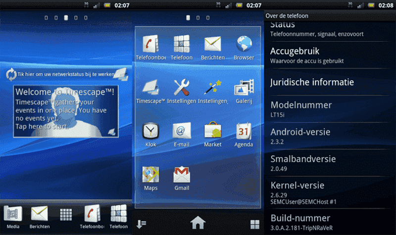

TripNArc Arc@xperia 0.8
For everyone who was so long awaiting for this new version, here it is! This will be a full port of the retail Arc rom. Feature updates from SE will be ported in this rom. Version 0.8 is first version fully based on retail rom .184! from Sony Ericsson. Rom is completely rebuilded. Issues with some parts of the GUI/UI are know and also identified how to fix. This will be fixed in later releases, please don't report them.
attachment.php
Rom information:
- Android 2.3.2 Gingerbread
- Arc@xperia 0.8
- BETA
- Based on the retail Arc rom!
- Prepared for my MIUI concept "TripNFeatures"
- 3.0.A.2.184 SE version
- Wifi hotspot not working or not properly working
- USB Tethering
- Baseband 49 advised
- Other baseband (with or without bb patch) untested

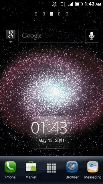

MIUI Arcified Android OS 2.2 Froyo
attachment.php
attachment.php
This is a modification of Cobrato's MIUI Froyo Rom.
A special thanks to cobrato
Thank you wolfbreak,Jerplea,Zdzihu,DooMLord and all devs
Screenshots attached at the bottom of the post
What's new-
1) Launcher -
Many people don't like MIUI launcher because it's iOS style. So I have changed the launcher to xperia arc launcher. You cannot use MIUI launcher on this rom. I had to delete that because I found it was somehow affecting the overall speed of Xperia Arc launcher.

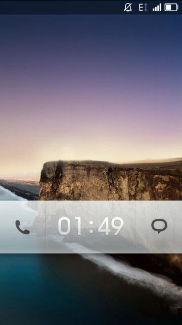

2) Lockscreen -
I know that MIUI Gingerbread rom Lockscreen looks very cool so I modified the original lockscreen on Cobrato's rom to look like MIUI Gingerbread lockscreen. Please read the bug report given below.
3) Camera -
This is not a big thing. Camera is fully functional except zoom. But on Cobrato's original MIUI, there were 2 camera apps. I have kept the MIUI camera in this rom.
4) Widgets -
I have added Arc Widgets in this Rom
5) Default theme -
I changed the default theme. (Again I'll say please read the bug report given below.
Working - Everything

1) LOCKSCREEN ISSUE -
While changing the lockscreen to look more sleek and neat, I made a mistake. If you apply any theme using theme manager, then the ockscreen reverts back to the one which is there in Cobrato's rom. I couldn't fix the issue.
But there is a solution. You cannot apply themes doesn't mean you can't customize this rom. You can use theme manager, but just enable 'edit theme settings' option. Then you will be presented with lots of options which you can customize. Do not change lockscreen, all other things you can customize. You can change wallpapers, it won't affect lockscreen.
