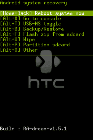

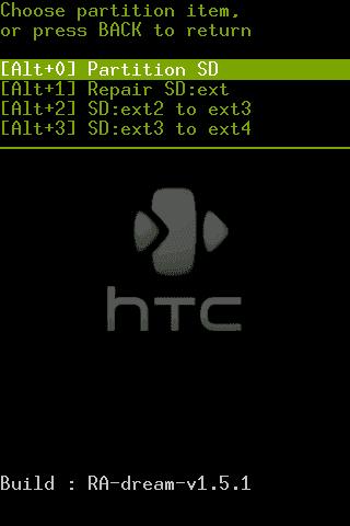

  • Extended menu (with keyboard-shortcuts):
    • [HOME+Back] Reboot system now :: reboot your phone
    • [Alt+X] Go to console :: bring up the console
    • [Alt+T] USB-MS Toggle :: enable/disable USB mass storage (use when the phone is connected to your PC)

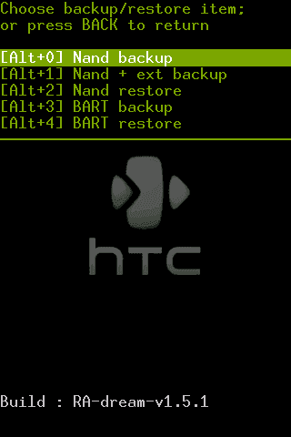

    • [Alt+B] Backup/Restore (recovery partition not included!)
      • [Alt+0] Nand backup :: Make a Nand backup
      • [Alt+1] Nand + ext backup :: Make a Nand + ext backup
      • [Alt+2] Nand restore :: Restore a Nand backup
      • [Alt+3] BART backup :: Make a BART backup (Nand + ext)
      • [Alt+4] BART restore :: Restore latest BART backup
    • [Alt+F] Flash zip from sdcard :: Flash a zip update file from your sdcard

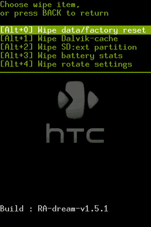

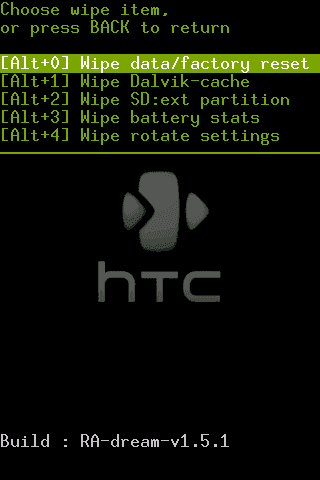

    • [Alt+W] Wipe
      • [Alt+0] Wipe data/factory reset :: Wipe /data and /cache
      • [Alt+1] Wipe Dalvik-cache :: Wipe Dalvik-cache both on /data and ext
      • [Alt+2] Wipe SD:ext partition : Wipe the ext partition on your sdcard
      • [Alt+3] Wipe battery stats : Wipe the battery stats in /data
      • [Alt+4] Wipe rotate settings : Wipe the sensor settings in /data

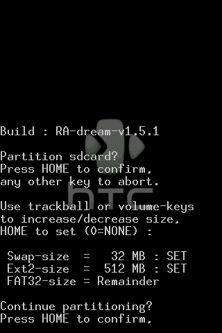

    • [Alt+P] Partition sdcard
      • [Alt+0] Partition SD :: Interactive SD partitioning
      • [Alt+1] Repair SD:ext :: Repair the ext partition
      • [Alt+2] SD:ext2 to ext3 :: Convert ext2 to ext3
      • [Alt+3] SD:ext3 to ext4 :: Convert ext3 to ext4

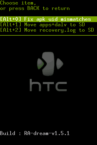

    • [Alt+O] Other
      • [Alt+0] Fix apk uid mismatches :: Does extacly that
      • [Alt+1] Move apps+dalv to SD :: Moves all apps and Dalvik-cache to sdcard (This will NOT enable apps2sd!)
      • [Alt+2] Move recovery.log to SD :: Moves the recovery log file to your sdcard. (Use when you want more detailed recovery log information)
