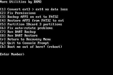

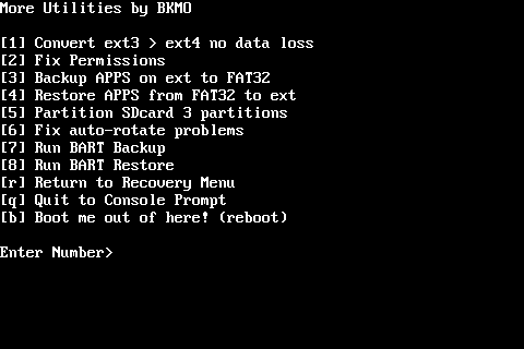

This is a custom recovery based on Cyanogen's v1.4 recovery.
The purpose of this recovery is to avoid using the console by accessing all features directly from the menu.
DO NOT USE
the recovery command to return back from console to recovery! Use the reboot command instead! Some scripts (like nandroid) will not work properly if you do so!
Features
  • full ADB access in recovery mode
  • Busybox
  • Extended menu (with keyboard-shortcuts):
    • Nandroid v2.2 backup and restore
    • Regular update.zip flash
    • Flash any .zip from your SD-card
    • Console
    • Wipe data + cache (factory reset)
    • Wipe ext partition on SD-card
    • Wipe Dalvik-cache on SD-card (NOT on /data !)
    • Partition SD-card : 500MB Ext2, 32MB Swap, remaining Fat32
    • Partition SD-card : Only Fat32
    • Repair ext filesystem
    • Convert ext2 to ext3
    • Fix package UID mismatches
    • Fix auto-rotate issues
    • Toggle USB-Mass storage on and off
  • Scripts available from console :
Download
Latest :
File-Upload.net - recovery-RA-dream-v1.2.3.img
Change-log :
v1.2.3
  • added squashfs to fstab (should fix issues accessing system and xbin for people using Cyanogen's ROM)
  • Replaced the GREEN-key by the HOME-key for confirmation
  • Removed the menu title to create more space
  • Added Wipe SD:ext partition
  • Added Rotate fix
  • Removed "Move apps to SD" because it's automatically implemented by most ROMs already.
  • Added confirmation before performing a nandroid backup
  • Set swap back to 32MB instead of 96MB when doing an auto partition SD-card from the menu
  • Upgraded fix_permissions to v1.32-R3
  • Added BART v0.9.2
  • Fixed many bugs (mostly in scripts)

Was genau ist dieses "Fix Rotate"? ergibt fuer mich jetzt grad keinen sinn.
Es dürfte fix-Bootlop sein.
Hab gerade mal nachgefragt was das es mit dem Fix Rotate auf sich hat, Antwort von Amon_RA :
@Friesenstahl No it's to fix the auto-rotate screen issues people have when they flashed too many roms .
Scheint also bei manchen Leuten zu Problemen mit dem auto-rotate des Displays zu kommen, und damit kann man es beheben.
Also sollte man das, direkt nach jedem flashen, zur Sicherheit ausführen?
Was meint ihr?
Kann bestimmt nicht schaden, ich werds allerdings erst testen wenn bei mir wirklich mal das auto-rotate spinnen sollte. Will ja auch sehen obs funzt *g*
Hat er über Symptome gesprochen?
Also wie macht sich das bemerkbar?
- Braucht er lange zum rotieren?
- Rotiert er gar nicht mehr?
Hatte nur allgemein zur Funktion gefragt.. über Symptome weiss ich leider nichts :(
Schade, wäre mal interessant *gg*
Vielleicht weiß das ja jemand und mag es uns mitteilen *gg*
Wenn ich raten müsste, würd ich sagen, dass es der Fix dafür ist, dass der Lagesensor manchmal einfach ausfällt.
