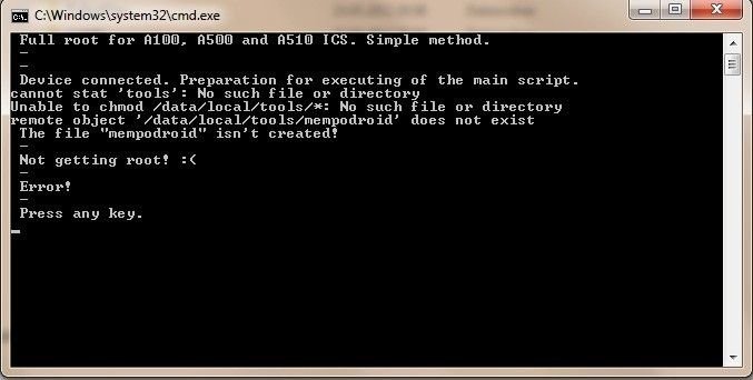

no root possible, was mache ich falsch?
P62fibQAAAABJRU5ErkJggg==
habe noch bei xda gefunden:
If you are like me, you are getting the error:
"mempodroid isn't created"
I found a solution. I'm not sure if this is anywhere else,
but I will post it here.
I am using Win7 64bit, Iconia a510
I installed Superuser BEFORE I did these steps.
I opened runit-win.bat in a text editor and found the step
sending me to the error and simply deleted it.
I deleted lines 19 -21:
Code:
adb pull /data/local/tools/mempodroid if not exist mempodroid goto ermem del mempodroid >nul
I "saved as" and just added a "2" to the filename: runit-win2.bat
I ran it again, got the reboot, got root
Have fun.
oder noch:
I'm posting this in case others find themselves in this situation with "Wait for Connect Device".
I installed 4.0.3, Builder Acer_AV041_A100_1.014.00_WW_Gen1. Running the batch file to root my tablet gave me Wait for Connect Device. I reinstalled the drivers from Acer's website twice. I reset my tablet through "settings" and then with the pinhole. Still nothing.
So I checked Device Manager (Windows XP SP3), and saw that Acer Composite ADB Interface has a yellow exclamation mark. I tried getting that to update, but Windows couldn't find anything more suitable than what's installed already.
Next I uninstalled Acer Composite ABD Interface (in Device Manager), unplugged my USB cable, replugged the cable, and it installed fine. I reran the root script, it ran through it's thing, my tablet rebooted, and was rooted! YAY! Got Superuser and Titanium Backup installed fine.
Thanks to everyone who's worked so hard on this tablet. Much appreciated!!

Full root for A100, A500 and A510 ICS. Simple method.
Device connected. Preparation for executing of the main script.
mkdir failed for /data/local/tools/, Permission denied
cannot stat 'tools': No such file or directory
Unable to chmod /data/local/tools/*: No such file or directory
remote object '/data/local/tools/mempodroid' does not exist
The file "mempodroid" isn't created!
Not getting root! :(
Error!
Press any key.
This is what i got.
