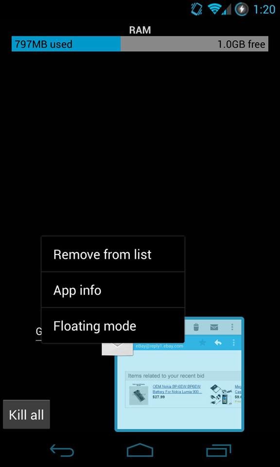

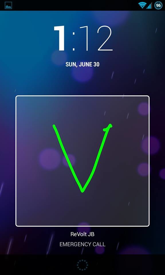

Gute Nachrichten:
Eine neue Nightly (30.6) mit nettem Changelog ist soeben erschienen (wird gerade hochgeladen...). Das kann nur heißen, dass eine Stable unterwegs ist.
Changelog :
1- Floating Mode from Recents Menu
2- Gesture Lock screen
3- Network Speed Indicator
4- Custom Toggle Colouring System
5- Halo Colouring System
6- Apollo Music Player Added
7- Fixes for Privacy Guard
8- HTC One users will feel a better experience due to a handful of merges thanks to Google open sources
9- Builds are fixed for n7000 and n7100 and should get Nightlies again
10- Add 2G/3G Toggle to profiles
11- MultiUser Selector on Lockscreen is now in a better layout
12- General Fixes and Memory leak fixes
