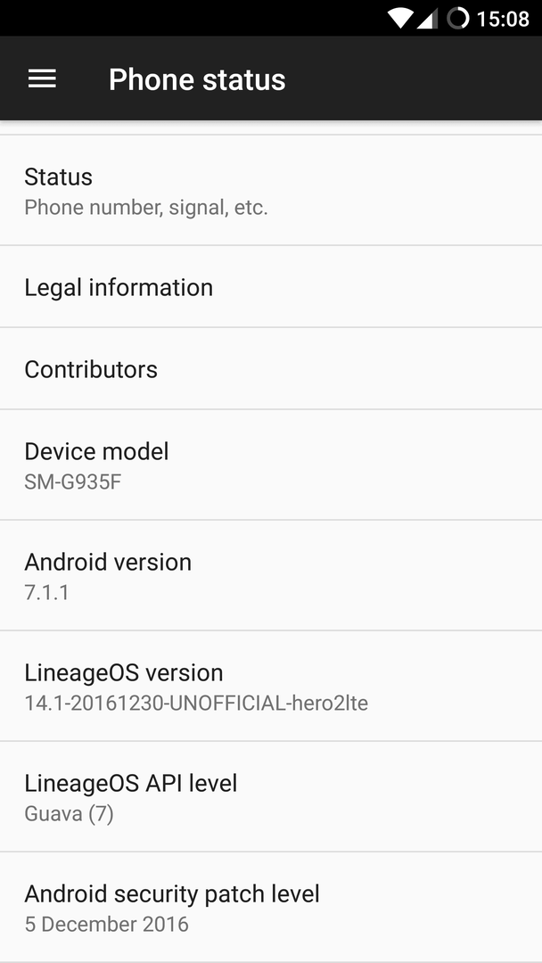

LineageOS 14.1 for Samsung Galaxy S7 Edge
Latest Build (26.09.2017):
lineage-14.1-20170926-nightly-hero2lte-signed.zip

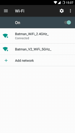

/* What’s working */
  • Audio
  • Bootanimation
  • Brightness Level
  • Bluetooth
  • Camera *needs to be improved

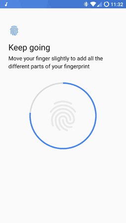

  • Fingerprint reader
  • Microphone
  • MTP
  • NFC
  • Wi-Fi
  • LED
  • RIL (calls, sms, microphone, data)
  • Torch
  • All sensors except fingerprint reader
  • SD Card
  • Capacitive buttons
  • Torch
  • Wi-Fi Hotspot

ROM OS Version: 7.x Nougat
ROM Kernel: Linux 3.10.x
ROM Firmware Required: N Bootloader and Modem
Based On: LineageOS
Version Information
Status: Nightly
Created: 2017-01-04
Last Updated: 2017-09-19

- Fingerprint deletion bug is now fixed by preventing users to enroll more fingerprints than what HW allow.

Fingerprint reader is now fixed.
