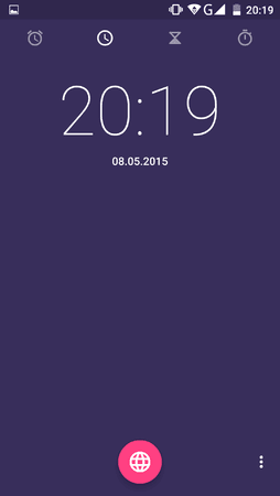

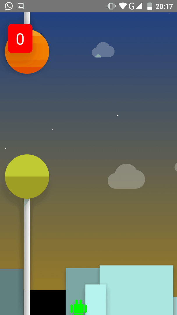

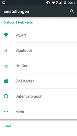

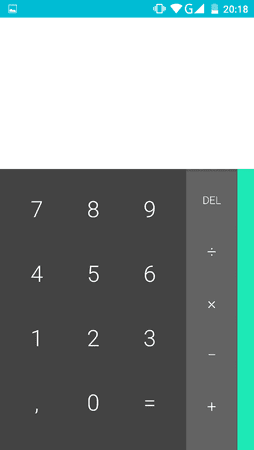

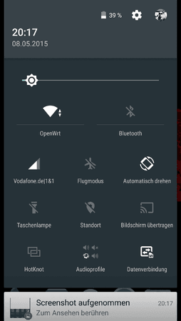

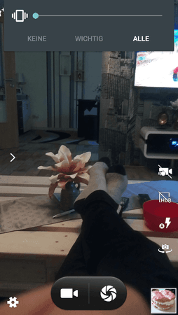

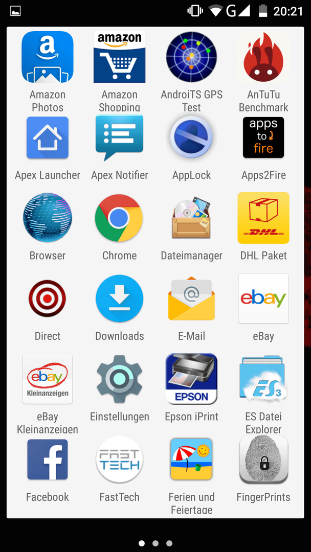

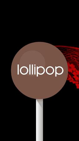

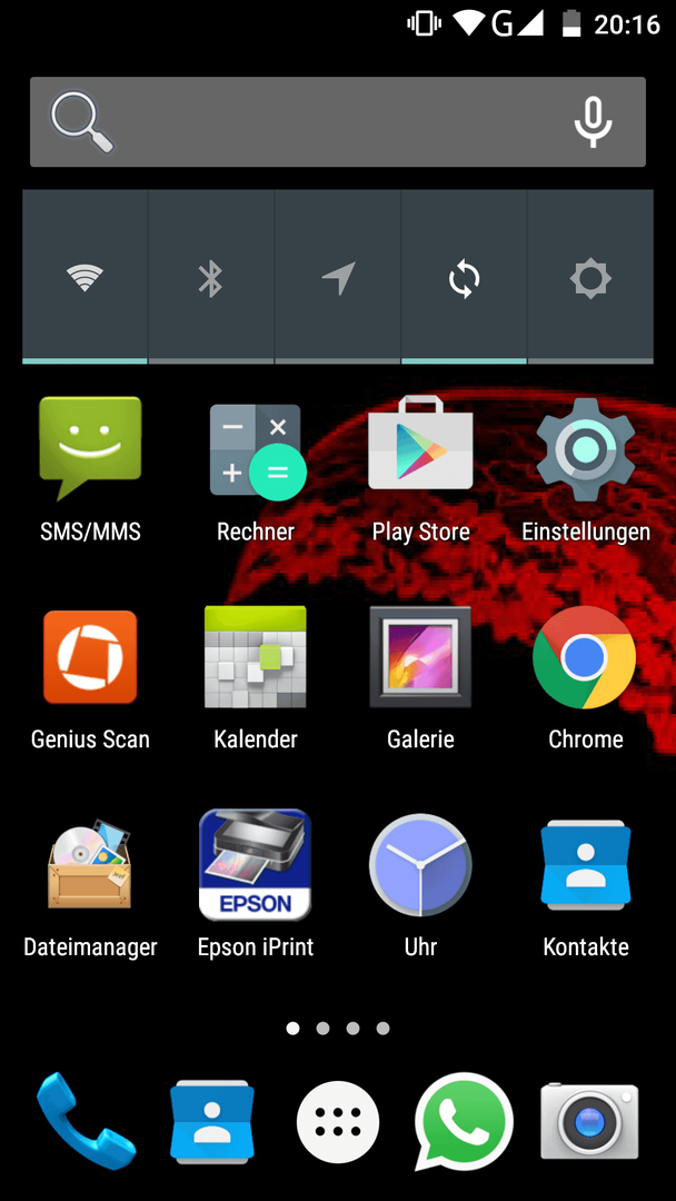

Nur mal so , aktuelles Android 5
uploadfromtaptalk1431109962845.pnguploadfromtaptalk1431109977007.pnguploadfromtaptalk1431109985119.pnguploadfromtaptalk1431109992193.pnguploadfromtaptalk1431109999385.pnguploadfromtaptalk1431110010294.pnguploadfromtaptalk1431110016347.pnguploadfromtaptalk1431110035300.pnguploadfromtaptalk1431110049777.png:rolleyes:
