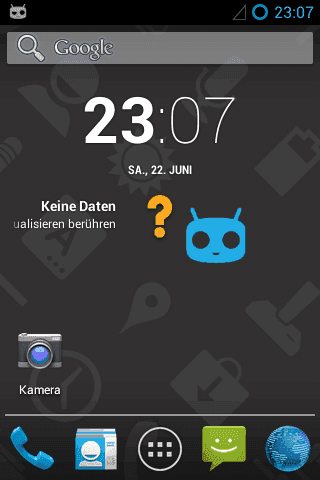

221039d1373290937-rom-4-2-2-cyanogenmod-10-1-u8666e-screenshot_2013-06-22-23-07-09.png
attachment.php
attachment.php
