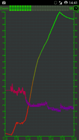

Letze Nacht hat es (mit neuem Ladegerät + Kabel) wieder voll geladen! :smile:
obwohl es auf 500mA gedrosselt wurde, das Akku hält jetzt auch wieder einigermaßen gut (s. Bild im Anhang und Logs, Deepsleep 66 %, -18,5%/h) :unsure:

V/ 4869.325307 c0 max77693_irq_thread: interrupt source(0x01)
V/ 4869.326081 c0 max77693_irq_thread: charger interrupt(0x01)
V/ 4869.326189 c0 max77693_bypass_irq: irq(432)
V/ 4869.328275 c0 max77693_bypass_irq: INT_OK(0x1c), BYP_DTLS(0x08)
W/ 4869.328381 c0 max77693_bypass_irq: chgin regulation loop is active
V/ 4869.374217 c0 max77693_softreg_work: INT_OK(0x1c), CHGIN(0x0), CHG(0x1), BYP(0x8), ST2(0x60), IN_CURR(900)
V/ 4869.374378 c0 max77693_softreg_work: unstable power
V/ 4869.378465 c0 max77693_reduce_input: 900mA to 800mA
V/ 4869.428526 c0 max77693_softreg_work: INT_OK(0x1c), CHGIN(0x0), CHG(0x1), BYP(0x8), ST2(0x60), IN_CURR(800)
V/ 4869.428662 c0 max77693_softreg_work: unstable power
V/ 4869.429291 c0 max77693_reduce_input: 800mA to 700mA
V/ 4869.478081 c0 max77693_softreg_work: INT_OK(0x1c), CHGIN(0x0), CHG(0x1), BYP(0x8), ST2(0x60), IN_CURR(700)
V/ 4869.478147 c0 max77693_softreg_work: unstable power
V/ 4869.478686 c0 max77693_reduce_input: 700mA to 600mA
V/ 4869.491141 c0 max77693_irq_thread: interrupt source(0x01)
V/ 4869.491682 c0 max77693_irq_thread: charger interrupt(0x40)
V/ 4869.491725 c0 max77693_charger_irq: irq(436)
V/ 4869.517140 c0 max77693_charger_irq: INT_OK(0x5d), THM(0x0), CHGIN(0x3), CHG(0x1), BAT(0x3), ST2(0x60)
V/ 4869.517721 c0 max77693_irq_thread: interrupt source(0x01)
V/ 4869.518261 c0 max77693_irq_thread: charger interrupt(0x41)
V/ 4869.518304 c0 max77693_bypass_irq: irq(432)
V/ 4869.519835 c0 max77693_bypass_irq: INT_OK(0x5d), BYP_DTLS(0x00)
V/ 4869.519877 c0 max77693_bypass_irq: bypass node is okay
V/ 4869.519920 c0 max77693_charger_irq: irq(436)
V/ 4869.529095 c0 max77693_softreg_work: INT_OK(0x5d), CHGIN(0x3), CHG(0x1), BYP(0x0), ST2(0x60), IN_CURR(600)
V/ 4869.529160 c0 max77693_softreg_work: stable power, reduce 1 more step for margin
V/ 4869.529845 c0 max77693_reduce_input: 600mA to 500mA
V/ 4869.547101 c0 max77693_charger_irq: INT_OK(0x5d), THM(0x0), CHGIN(0x3), CHG(0x1), BAT(0x3), ST2(0x60)
V/ 4870.049718 c0 max77693_get_cable_type: VB(0x1), CHGTYP(0x0)
W/ 4870.049763 c0 max77693_get_cable_type: D+/D- ovp state
W/ 4870.050732 c0 max77693_get_cable_type: cable type(2)
V/ 4870.057872 c0 max77693_set_input_current: now in soft regulation loop: 500
