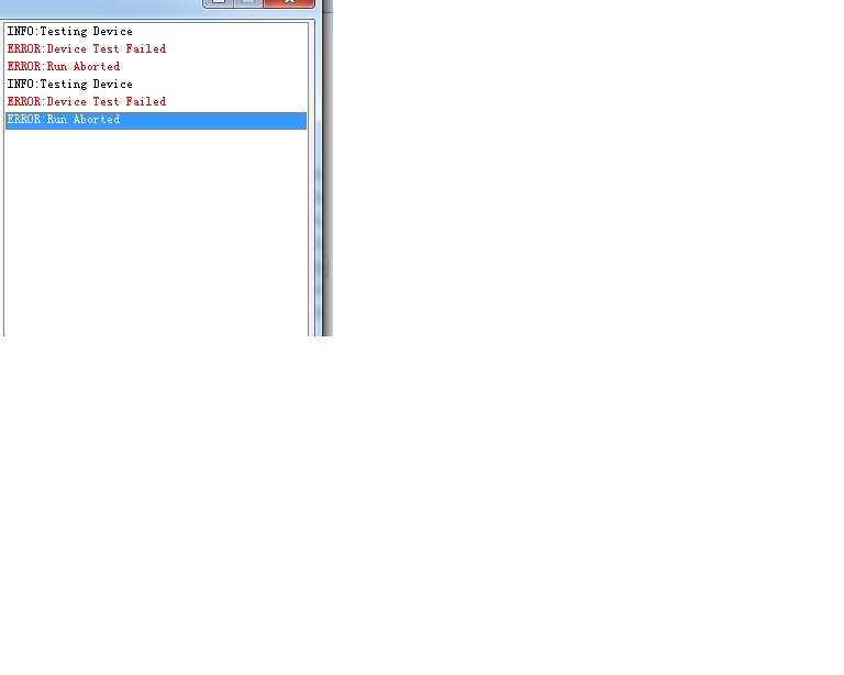

Help me have the same problem 7316 I did everything according to the instructions through the kkorc tool, it was stitched, but it comes to the MEDION splash screen and everything, did a hard reset, tried through the Rkandroid tool program as you wrote, but gives a device test failed error, what can I do?
UDP still flashed the bootloader 1.24, it stopped turning on altogether (
@KGSXA
I am sorry, I am not occupied anymore with flashing of 6 or more years old tablets. If you follow all the instructions I gave in this thread, and most important in the "kkorc" thread (there is an english section at the end of the tutorial), it should work.
Except from this, your post is a mixed up telling of what you did or not; so I couldn't possibly follow your intentions.
