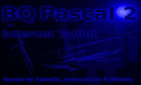

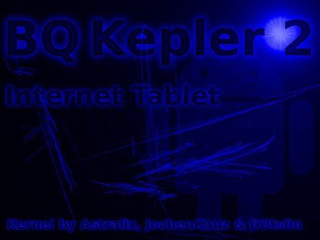

Update for Kepler2 and Pascal2 and Oma's JB
Features Kepler2/Pascal2:
Max CPU 1104MHz
Min CPU 24MHz
DDR Ram 1024MB/430MHz
BT-Stack Update by fr3ts0n
If someone tries the Oma CM10 and the screen rotates 90 degrees wrong, I'm abe to make a special CM10 Version of the kernel.
Please give feedback!
  • JK-JB-Kepler2-oc1104_20121114.7z
  • JK-JB-Pascal2-oc1104_20121114.7z
Reaktionen: pais83 und lmemperador
thank you so much jochenkauz, your new kernel boots fine (the new bootlogo is impresive xd) hdmi works, otg works, bt i fail to manage (maybe my bt adapter)

hey, new kernel !!!
wow, great blue boot logo... :razz:
