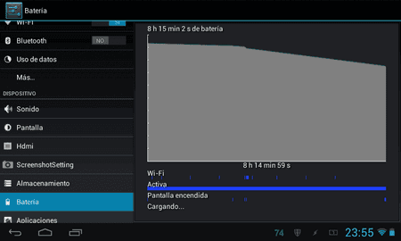

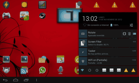

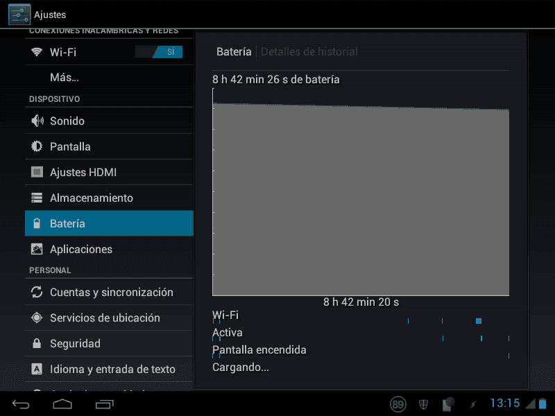

hi JochenKauz, i have been testing your last kernel in pascal2 with oma jb rom 1.2.2, well, in all your kernels i have seen one behaviour that i want to tell you. i am happy with your kernel but maybe it could be better
here we go...when the PASCAL2 is charging and reach 100% of charge, the ray icon in the battery never disapear (and it must disapear), i think that is not charging at full capacity, and when i unplug the charge cable the battery drops quickly from 100 to 95 %. very quickly i think
and the other thing is that in battery graph (settings - battery - details) i can see that the PASCAL2 never enters in "stand by" mode, the "active" bar in the graph is always on.
attached two photos comparing the two graphs of the battery, one is the official rom and the other with the oma rom and your kernel
thanks a lot man
You are right, thats a difference, but I'm not sure if the disapear of the ray icon is something that comes from the kernel. I think it is more a difference in the OS, ICS vs. JB. In my understanding the ray icon does not show that a charging occurs, no it shows that the AC is plugged in. The charging process is not controlled by the OS, it is controlled by the board. On my X8 I have a LED on it which indicates that an AC is connected, and it show a red light if charging and an orange light when charging is finished. Just in the MOment when this LED switches to orange, the OS also switches state from charging to charged in the lock screen. So I think the cut off signal is given to the OS correct, but that is another signal than the signal for AC plugged in or not.
Another indicator for my suggestion is the behavior of the StockRom kernel together with JB. the StockRom was not able to signal the battery status correct. That what I think is, that the signals now work correct, and the kernel only signals both things, fully charged and AC plugged in/not plugged in.
This is something I can not see on my X8, it goes to standby very well.
Please use the NoFrills CPU Meter to look at your statistics, in that app you cann see all speed steps the kernel was taking. Are you sure you have no background process that pretends the Pascal2 to go into standby?
understood first part, ok but i think that my other devices with jelly bean when charged ray icon disapears...i will look a t it more closely, that's not a real problem
second part, graph, no i have not apps in background forcing not going to sleep...one thing i have noticed is that this always happens with roms with microsd (ext sd) as nand, the trick for gamers....LOL, i think this is problem. in oficial rom with normal NAND (internal as nand) goes to sleep and when i use oficial rom with ext_to nand fix, this occurs, tablet never enters stand by mode, so i think it is for using the micro sd for OS...
using no frills cpu i can see that 24 mhz is never reached, in pascal2 and in kepler2. only 104 mhz is the minimum limit reached
what do you think?
thx a lot man
Yes could be with the external sd, cause I always use Oma's intsd to NAND fix.
Regarding 24MHz, you are right my minimum frequenz is 104 too, after that it goes to standby. I think that every job needs more cpu than 24MHz.
