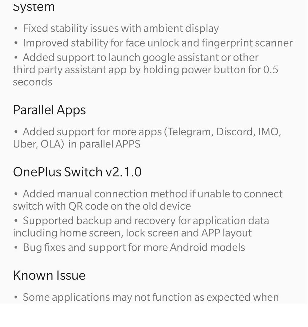

OxygenOS Open Beta 3 for OnePlus 6
System
  • Fixed stability issues with ambient display
  • Improved stability for face unlock and fingerprint scanner
  • Added support to launch google assistant or other third party assistant app by holding power button for 0.5 seconds
Parallel Apps
  • Added support for more apps (Telegram ,Discord,IMO, Uber, OLA) in parallel APPS
OnePlus Switch v2.1.0
  • Added manual connection method if unable to connect switch with QR code on the old device
  • Supported backup and recovery for application data including home screen, lock screen and APP layout
  • Bug fixes and support for more Android models
Known Issues
  • Some applications may not function as expected when running on this beta version
  • Google Pay service is not working
Die Google Gesten funktionieren nun auch mit z.B. Nova Launcher fehlerfrei.
