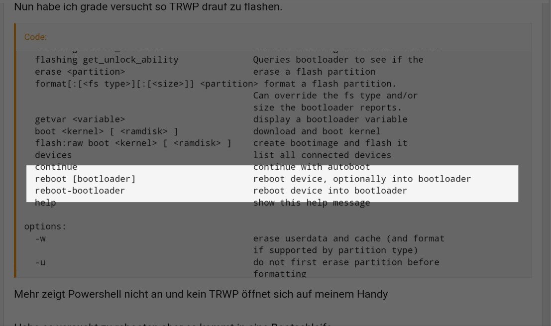

Ich habe versucht mein Xiaomi Note 8 Prop zu rooten nach dieser Anleitung: Xiaomi Bootloader entsperren, Custom Recovery, Root & Custom Rom - Schritt für Schritt Anleitung
Nun habe ich grade versucht so TRWP drauf zu flashen.
Code:
PS C:\adb> fastboot flash recovery recovery.img
target reported max download size of 134217728 bytes
sending 'recovery' (29044 KB)...
OKAY [  0.724s]
writing 'recovery'...
OKAY [  0.255s]
finished. total time: 0.984s
PS C:\adb> fastboot reboot recovery
usage: fastboot [ <option> ] <command>
commands:
  update <filename>                        reflash device from update.zip
  flashall                                 flash boot, system, vendor and if found,
                                           recovery
  flash <partition> [ <filename> ]         write a file to a flash partition
  flashing lock                            locks the device. Prevents flashing                                           partitions
  flashing unlock                          unlocks the device. Allows user to                                           flash any partition except the ones                                           that are related to bootloader
  flashing lock_critical                   Prevents flashing bootloader related                                           partitions
  flashing unlock_critical                 Enables flashing bootloader related                                           partitions
  flashing get_unlock_ability              Queries bootloader to see if the                                           device is unlocked
  erase <partition>                        erase a flash partition
  format[:[<fs type>][:[<size>]] <partition> format a flash partition.
                                           Can override the fs type and/or
                                           size the bootloader reports.
  getvar <variable>                        display a bootloader variable
  boot <kernel> [ <ramdisk> ]              download and boot kernel
  flash:raw boot <kernel> [ <ramdisk> ]    create bootimage and flash it
  devices                                  list all connected devices
  continue                                 continue with autoboot
  reboot [bootloader]                      reboot device, optionally into bootloader
  reboot-bootloader                        reboot device into bootloader
  help                                     show this help message
options:
  -w                                       erase userdata and cache (and format
                                           if supported by partition type)
  -u                                       do not first erase partition before
                                           formatting
  -s <specific device>                     specify device serial number
                                           or path to device port
  -l                                       with "devices", lists device paths
  -p <product>                             specify product name
  -c <cmdline>                             override kernel commandline
  -i <vendor id>                           specify a custom USB vendor id
  -b <base_addr>                           specify a custom kernel base address.
                                           default: 0x10000000
  -n <page size>                           specify the nand page size.
                                           default: 2048
  -S <size>[K|M|G]                         automatically sparse files greater
                                           than size.  0 to disable
PS C:\adb>
Mehr zeigt Powershell nicht an und kein TRWP öffnet sich auf meinem Handy
Habe es versucht zu rebooten aber es kommt in eine Bootschleife
Was ist schief gelaufen?
Danke im Vorraus :*
Ja, weil der Befehl "fastboot reboot recovery" auch falsch ist - deswegen wird dir die komplette Syntax des fastboot Befehls angezeigt.
Also entweder "fastboot reboot" eingeben und dann die entsprechende Lautstärketaste beim Booten halten - oder gleich manuell das Gerät ausschalten und ebenso manuell weiter verfahren.
