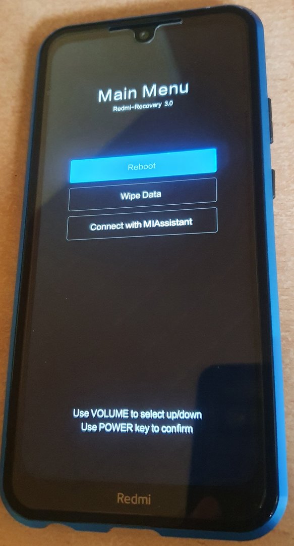

Download the correct image file and copy the file into the same folder as your platform-tools. Rename the image to twrp.img and type:
fastboot flash recovery twrp.img
fastboot reboot
Note many devices will replace your custom recovery automatically during first boot. To prevent this, use Google to find the proper key combo to enter recovery. After typing fastboot reboot, hold the key combo and boot to TWRP. Once TWRP is booted, TWRP will patch the stock ROM to prevent the stock ROM from replacing TWRP. If you don't follow this step, you will have to repeat the install.
Okay das war mein Fehler.BOotnoOB schrieb:@Astronaut2018 Kein Reboot ins System!! Direkter Neustart in die Recovery über den Menüeintrag "Neustart" im TWRP-Hauptmenü.
