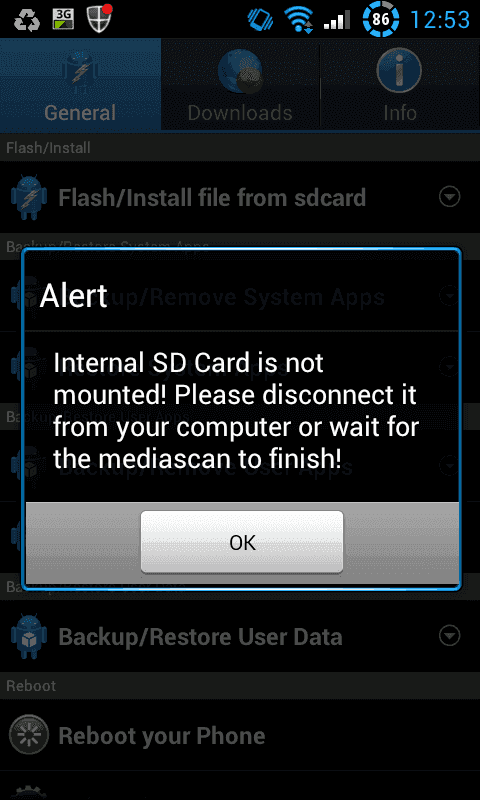

Meine LRToolbox streikt - but why ??? :crying:
