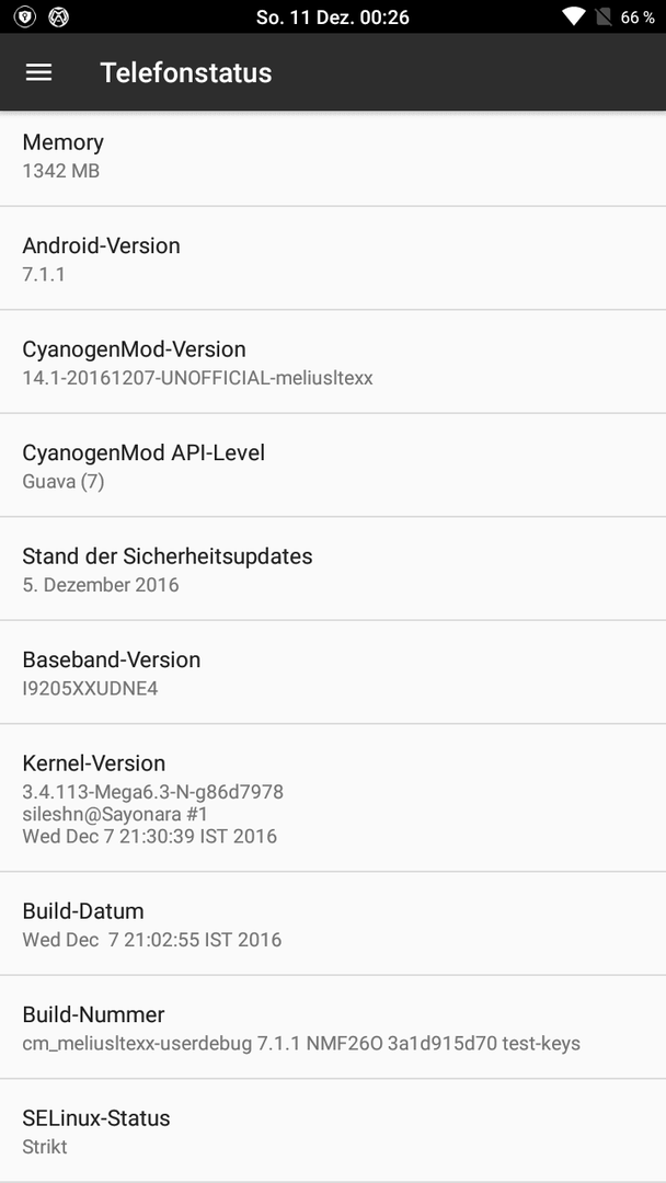

The last update (20161207) works wonderfully.
Thank you.
Reaktionen: sileshn
RR or CM?
Reaktionen: sileshn
U didn't try substratum version? Full theme support available. Link below if u r interested.
MEGA
Screenshot from my device. I don't use the mega anymore.
Reaktionen: Cris
