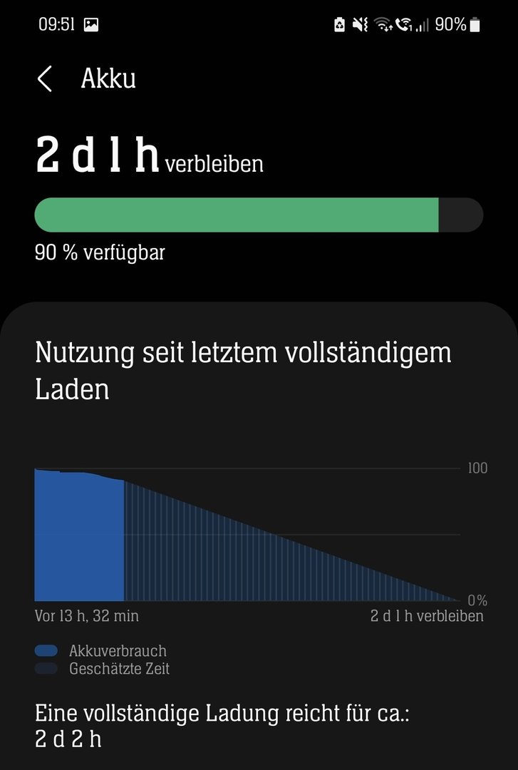

Scheint was zu bringen mein nur Modem Flash
