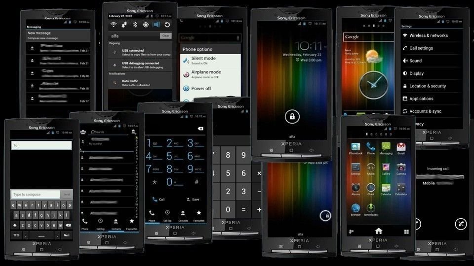

ICS-THEME
SKYPE VIDEO CALLING für das X10 (2.2 and onwards) Finally....
Download the app
App-Version: 2.7.0.907
Größe: 13M
ICS-THEME
(siehe Bild oben)
XDA: ICS Theme full
gkassar
Heres a brief description about what was moded / changed in V1.0
- changed the global background to full black
- changed the lockscreen to a single button ICS style one
- changed the app icons of most system apps (with a brand new compiled ICS style alarm icon)
- totally replaced stock calculator app, messaging app and the default keyboard
- changed the bottom menu bar of the stock alarms clock to full black & the clock widget
- added a new second ICS analogue clock widget
- changed the dialer, call log, contacts & favorites icons, background & buttons
- changed the infiniteview & some of the calling/incoming call background & buttons
- changed the status bar layout
- changed the image when you plug in the device to a USB mass storage
- replaced the icons in the power button options
- changed the settings menu icon of xLoud & Bravia add-on to match ICS theme
Heres a brief description about what was moded / changed in V1.1
- changing the page indicators & some settings icons in Home launcher
- new bootscreen from the upcoming ICS of Xperia S
- more ICSish work to phonebook & related apks
- ICSish makeover for the stock alarm clock
- ICSish Google search widget
