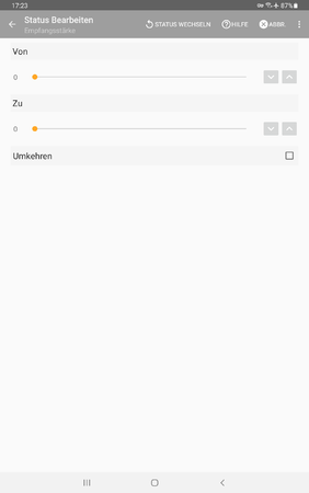

@PaulFE Hallo, falls Du Tasker verwendest, damit geht es.
Du kannst die Empfangsstärke (Stufe 1-8) auslesen (siehe Screenshot) und davon abhängig Aktionen starten.
Zusätzlich kann man auch die Variable %CELLSIG verwenden:
Cell Signal Strength (monitored,dynamic)
%CELLSIG
The current phone signal level from 0-8 inclusive on a rougly linear scale. On some phones, the level will rise in steps of 2 (0,2,4,6,8). The value is -1 if the value is unknown or there is e.g. no service.
From Android 4.2, Tasker version 4.3+, cells could be found from 2 different network types simultaneously. In that case, the value is reported with preference for the network type leftmost on the list: GSM, CDMA, UMTS, LTE.
There is a bug with some Android versions that the reported signal strength is not updated until the device is turned off and on.
