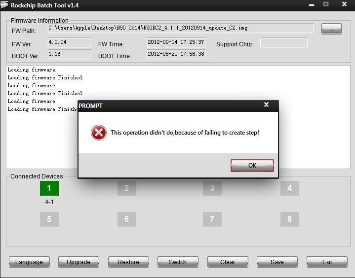

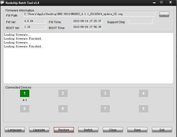

Hi, ich hoffe Ihr könnt mir helfen...ich versuche die ganze zeit mein window n90 zu updaten und bin ganz nach dieser anleitung gegangen:
How to upgrade
I. Preparation
1. Choose and download an IMG (Firmware):
a) StockROM: Yuandao Firmware download page
CustomROM: Vondroid CFW for window N90 II (BZ-CZ version)
2. If necessary download "RKbackTool".
3. Extra Driver shouldn't be needed, Win7 will recognize the device -> therefore don't install manually ADB, or USB-Driver.
4. Charge Tablet to >70%
II. Flash
1. Turn tablet (off) and disconnect every cable and charger.
2. Start on PC "RKBatchTool.exe" and choose under the item "FW Path" an IMG (see I. Preparation).
3. Now press Volume (+) on tablet -> keep pressing and connect at the same time the tablet (upper microUSB port, not OTG) with PC -> as soon as you hear the PC is successfully connected or you see in RKBatchTool under "Connected Devices" a green light, then you can stop pressing Volume (+) and the tablet should be recognized from "RKBatchTool".
4. Click in RKBatchTool "Restore" (not Upgrade) and the flash process should begin; the first-time boot will last longer than normally - you can close RKBatchTool and disconnect the USB cable as soon as the tablet is booted.
More instruction can be found here.
wenn ich haber auf restore clicke, dann bekomme ich diese fehlermeldung: "this operation didn't do, because of failing to create step"
wo liegt das Problem?
ok habs...ich hatte rkbatch tool 1.4 gehabt...mit der 1.5er hat es dann funktioniert...
