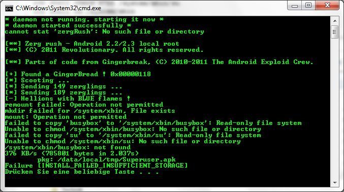

Hallo ONeill,
I regret it very much that I upgraded my Android at last to version 2.3.5 cause now I have this SW-Version 2.26.401.3 !...
(s. the attached screenshot of the failed SoftRoot process)
May I ask what HTC has changed at this version so that ZergRush does not have access to /system/xbin anymore?...
Just changed the rights of this folder maybe?...
I supposed to be able to use with SoftRoot apps just like 'MyBackup Root' to be able to backup app data as well. Is this correct?
Cause then I could e.g. rescue my favorites (favorite destinations) of my offline navigation app as well when rooting my Wildfire S and changing over to Cyanogenmod7+Data2SD (so few telephone storage currently available!!).
This would be worth very much for me!
Aren't things like that possible with a SoftRoot?...
Or will I be able to save those data also by mirroring the SD card with the related folders?...

du kannst hier auf deutsch schreiben :) If you want to read the answer or my feedback in english, please scroll down ;)
Also es ist so, das, wie hier im Thread weiter vorne bereits gesagt, die Methode mit zergRush nur bei der Androidversion 2.3.3 von HTC funktioniert, alles was danach als Update kam, kann leider nicht mehr gesoftrootet werden.
Zum Thema PermaRoot, wenn du das mit HTC Dev machst, sind alle deine Daten gelöscht, das ist richtig. Es gibt aber bei den XDA's auch irgendwo einen Thread, wo ein Tool entwickelt wurde, welches dein Bootloader ohne HTC Dev unlocked. Inwieweit das aktuell ist, weiß ich allerdings nicht.
====== English version =====
So, like said before in this thread on another page, the method posted in the first post does not function on all Android versions provided from HTC for Wildfire S higher than 2.3.3.
PermaRoot with HTC Dev will wipe the data partition of your phone, so all data will be lost, thats true. The XDA-developers forum has a thread in wildfire s section where you find a tool to unlock your bootloader without HTC dev, but if this thread is actual or not, i'm not sure.

Nein, denn zum Downgraden braucht man wiederum SoftRoot, also zergRush (HTC Wildfire S/Downgrade)
3.) Warum eigentlich geht zergRush bei der aktuellen Version denn plötzlich nicht mehr? Warum ist jetzt auf einmal der System-Ordner nicht mehr beschreibbar?... Warum ging es zuvor noch? Usw.
Oder hat es nur niemand mehr an die aktuelle Version angepaßt?...
Schreibrechte auf dem System gab es auch vorher nicht ;) HTC hat am System rumgepfuscht, sodass die Methode, die zergRush nutzt nicht mehr funktioniert. Was genau, kann ich dir nicht genau sagen, da müsste man untersuchen, wie zergRush genau funktioniert und dann kann man gucken, an welcher Stelle zergRush aufgeben muss und kann daraus die Änderung herleiten.
