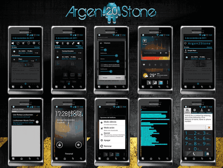

First of all Many Thanks to walter79, He ported my ROM to Defy.
Changelog:
Based on Ms2 Ginger1.0
zipaligned
updated and modded bootmenu
overclock and init.d removed
updated CWM
ICS Layout
Bootanimation RAZR
Scrollable quickpanel on statusbar
Power menu with Sleep Mode and Reboot
Lockscreens AOSP Slides & Rotary
Robonot Fonts
=> next release will be based on ms2ginger 2.0 or newer
