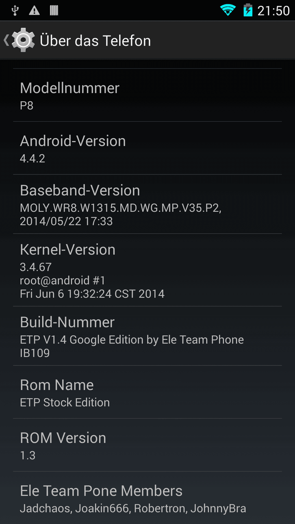

Hardware : MT6592
Model : P8
Build number : ETP V1.4 Google Edition by Ele Team Phone IB109
Build date UTC : 20140620-035529
Android v : 4.4.2
Baseband v: MOLY.WR8.W1315.MD.WG.MP.V35.P2, 2014/05/22 17:33
Kernel v : 3.4.67 (root@android) (gcc version 4.7 (GCC) ) #1 SMP Fri Jun 6 19:32:24 CST 2014
Uboot build v : -----
LCD Driver IC : 0-RX_572R_808A
